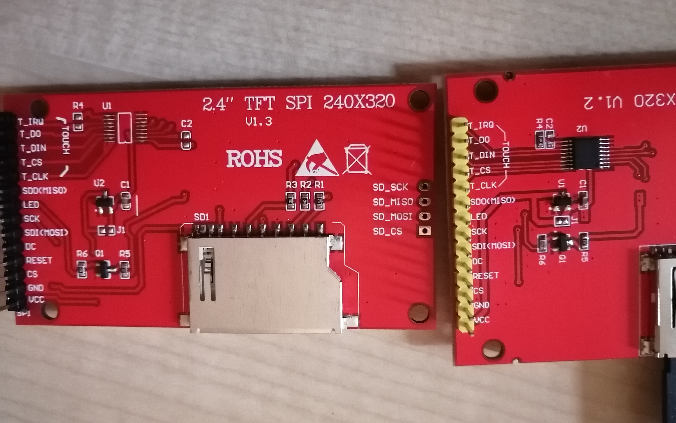

two things I've noticed so far.
1. GUI CALIBRATE stays foreverin the first page...
Has anyone gotten this to work yet?

I have never set up a touchscreen on the Pico, so I may have done something wrong.
The crosshairs stay at the top left and he wants me to press and hold, but nothing happens. I tried this with 2 different displays so I'll probably have to check the soldering points

Hi Martin, All,
Re. The calibrate locking up.
Firstly, try shorting out the solder pads on the TFT’s onboard regulator so there is no voltage drop to the touch controller chip.
Secondly, it ‘could be’ the old MISO problem, you could try cutting the touch-miso pin off the TFT display
Thirdly, check the option settings and make sure the touch options are set correctly.

Last time I used touch, it required a "sharp" tip to activate the touch during calibrate. Nothing like what I am used to in operating my mobile phone.
Diagnosis: doe the SD card work ? It shares lines with touch.

As far as I know there hasn’t been any MISO issue with the ILI9341 TFT displays in the past so I doubt it is the issue.

Hi Tom,
you are right .. the second display has no U2 (U1 in this case) so there will be no Touch at all.
But the 2.8 ' Display, which I connected first has it. But this one has a crack in the Display so it is possible, that touch is broken.
I had already ordered a new one, so I'll try it when it arrives.
