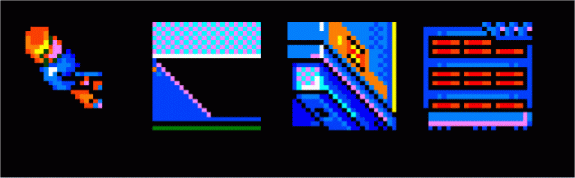

At the moment I'm in the process of giving the sprites a frame so that they can stand out better from the background.
From                      ---->            To
Like Imagine / Ocean often done for Spectrum
