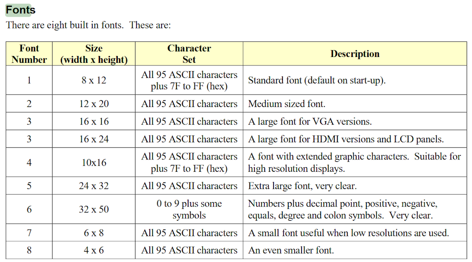

  thwill said  Font 7 is this one, hadn't noticed the name was backwards before: https://github.com/thwill1000/mmb4l/blob/main/src/fonts/Font_8x6.h - not my doing, from the original MMBasic source.
That’s right, it’s 8x6, but we’re looking for 6x8. According to the Picomite manual, Font uses the 6x8 format.
I was referring to the fact that the filename "Font_8x6.h" suggests it contains an 8x6 font whereas it clearly contains a 6x8 font. The same file exists in the PicoMite source repository.
