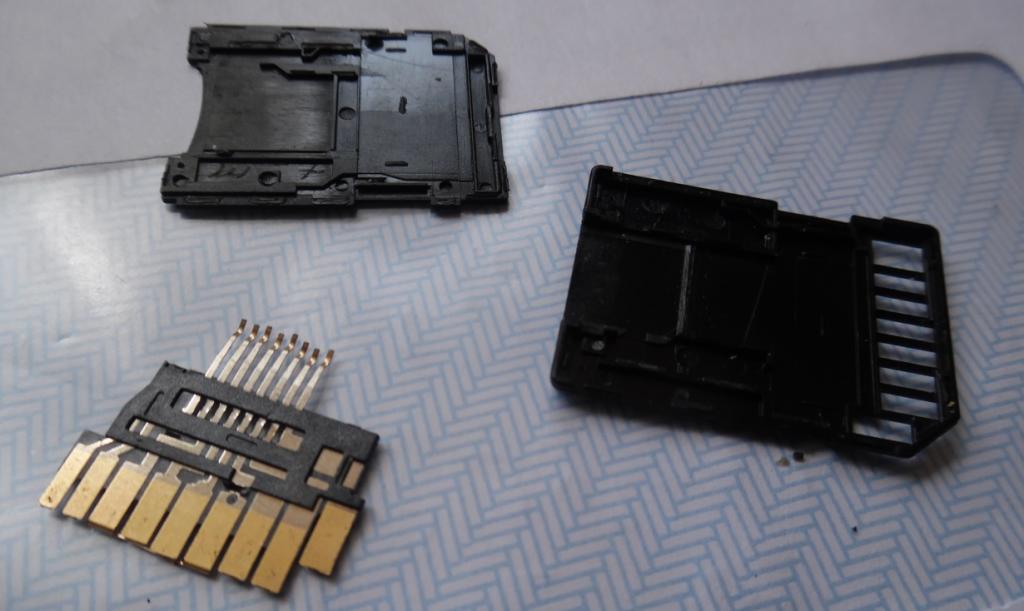

The plastic of adapters is not suited for soldering. But if you have the skills (speed, do it first time right, use leaded solder) you can do it without melting the plastic where the contacts are aligned. And the adapter will still function.
Matter of skills.
But honestly, these adapters are not made for frequent insertion and extraction of the micro SD card. After about 100x they start to fail.
Conclusion: you can make it work...to certain limits
Posted: 01:19pm 22 Jun 2023
They come apart with a thumb nail. Easier to solder and retention the contacts.
Maybe false economy. I'll try the sdcard adaptor on another non waveshare picomite but it's not fun anymore, I'm loosing interest in diy.
Posts: 9233
Posted: 01:28pm 22 Jun 2023
I've never seen one in bits before. :) Looks like you need to clean the contacts and, if possible, put some flux on them before soldering. Solder hot and fast for best results because keeping the iron on for too long is what melts the plastic.
Posted: 01:40pm 22 Jun 2023
  Mixtel90 said  I've never seen one in bits before. :) Looks like you need to clean the contacts and, if possible, put some flux on them before soldering. Solder hot and fast for best results because keeping the iron on for too long is what melts the plastic.
It's a pcb. It's the case that melts. Definitely clean the contacts before soldering. My friend said "you can only solder new vero board".. true, unless you clean it.
