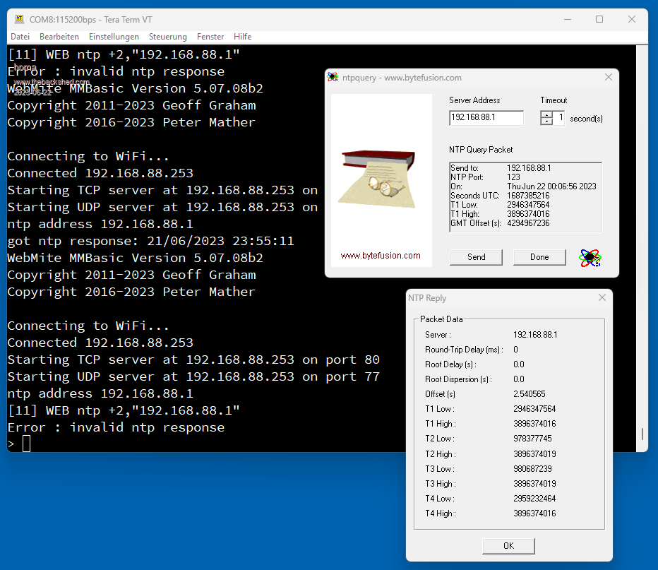

NTP server on a MikroTik router with a WebMite causes problems. If the AP has no internet (but the time and internal clock are correct!), the NTP query does not work with the WebMite.
A test tool "ntpquery", on the other hand, has no problems (regardless of whether the AP has internet or not!).
Is there possibly a bug in the ntp query of the WebMite?

My uneducated guess is:
The pico is 'probably' doing a DNS lookup. It doesn't know if the supplied string is a domain name or ip address.
If you can run a packet sniffer on the MikroTik, you should see the DNS lookup requests.

The code already identifies numerical IP addresses and doesn't do a DNS lookup on them so this isn't the issue.

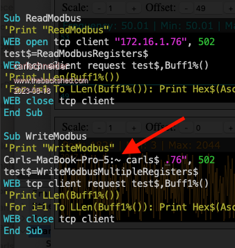

I’m running a 13” mid 2012 MacBookPro running Ventura 13.1 through the OpenCore Legacy Patcher. I use the MacOS X Terminal application and Screen to link to the USB port. The hardware is all there, supported by the drivers and the install is stable. The image below with the red arrow is pointing to the command prompt that has come through while in the EDIT mode. This is due to the WEB OPEN CLIENT failing because the ModBus Slave (ModBusPal.jar 1.6c) has been turned off to replicate the problem. To get back into WebMite I up arrow once to load the Screen command at the Terminal prompt and hit enter. This gets me back to the WebMite session and the command screen, without the > prompt. Enter once and the WebMite Starts running again with the following output. This is repeatable by using WEB OPEN TCP CLIENT “ip address”, 502 with no Modbus Slave responding. If I take too long doing this sequence then I have to reset the PicoW to get the USB working again. It would appear that Telnet is also not available, but I have not been able to definitively confirm that yet.
Web Open Client failure
If I F2 then ^C and wait at the command prompt I get the following
Connected XXX.XXX.XXX.XXX
Starting TCP server at XXX.XXX.XXX.YYY on port 80
XXX.XXX.XXX.XXX
ntp address 216.197.228.230
got ntp response: 17/08/2023 09:13:30
09:13:30        Here we go
[123] WEB open tcp client "XXX.XXX.XXX.XXX", 502
Error : TCP client
> Carls-MacBook-Pro-5:~ carls$

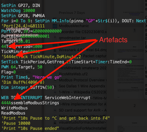

I’m using a Logitech MX Master mouse, linked through Bluetooth. A rapid spin of the scroll wheel inserts artefacts into the EDIT view. These artefacts are persistent in that these are ascii characters inserted into code. Page up and then Page down does not dislodge them. Recovery is through Esc Y F4 sequence. The image below shows the artefacts, as red arrowed. I was initially thinking this was a USB issue but the mouse is Bluetooth connected. Unless the Bluetooth stack is hanging off the USB Hub? One of the tricky aspects in making OpenCore Legacy work is the USB side of things and the WIFI support. In this instance the chipsets are supported by native Apple drivers, just disabled by Apple in their OS upgrade cycle. Maybe related maybe not.
Image of artefacts

3. Mac issue - can't comment. Haven't had similar reports from anyone on Linux/Windows
4. Mac issue - can't comment. Haven't had similar reports from anyone on Linux/Windows

With regard to the Tick error it's starting look like it occurs with the following sequence of events.
From running program at the console
^C
F4
Edit some code (possibly looking like delete some code rather than add code)
F2
But I'll keep my eye on it and provide more feedback. The only definite consistency is the Tick command failing. So far just another F2 and everything is fine.
