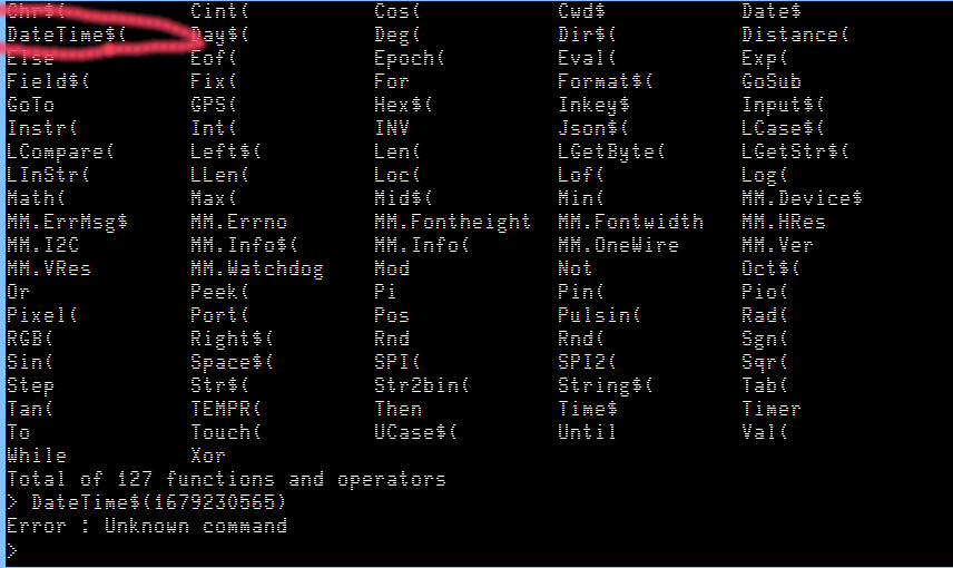

I may have missed some details somewhere,  but on FRESH install of PicoMiteWebV5.07.07a24.uf2, if the only thing I setup so far is the WIFI so I'm connected...
If I type:
> datetime$(1679228317)
Error : Unknown command
Above is what I get.
Did Adding TFTP and NTP support remove working with EPOCH time to set TIME$ and DATE$?

  Quote  If I type:
Which section of the manual is datetime$ in? Functions?
Edited 2023-03-19 22:31 by matherp

Posted: 12:36pm 19 Mar 2023
yes,  but oh geez... I was trying to shortcut and do stuff in immediate mode... not a program. Maybe that can be it?
Obviously... I'm very confused.

Posts: 4405
Posted: 01:07pm 19 Mar 2023
DateTime$() is a function not a command.
Do:
? DateTime$(...)
Posts: 12058
It is a function not a command
I think you are miss-remembering
rtc settime datetime$(now)
Note though that on the WEB version data$ and time$ are automatically set by WEB NTP
Edited 2023-03-19 23:08 by matherp

Posted: 01:13pm 19 Mar 2023
Ok, I clearly need more coffee...
Note: I was looking into using the "time" API (see other thread on "WEB CLIENT" code)   because WEB NTP fails for me... a lot. And on one of my Pico W's, whenever WEB NTP fails back to ">" prompt... there is a good chance program is also gone from memory.
Type "list" and get "nothing"
Edited 2023-03-20 00:18 by pwillard
