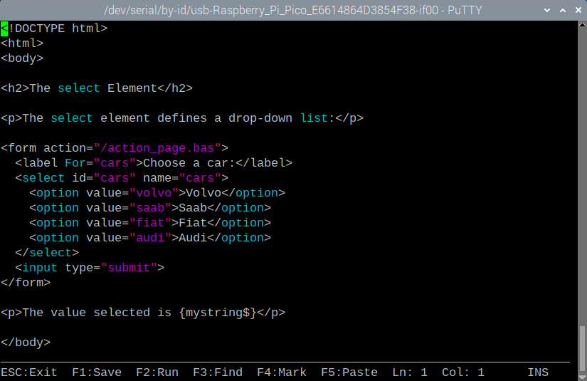

Hi All;
This is probably a trivial thing for most, but when I want to make a quick change to the HTML page I am testing, I bring it into the editor and then save it out to the sdcard.
Example;
The /action_page.bas is WIP (don't ask).
Thought I would just mention this,
Hans ...

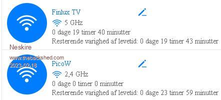

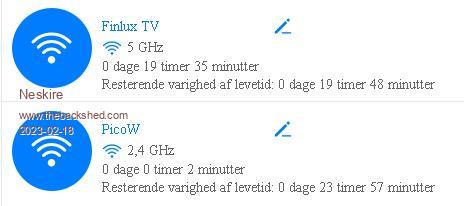

Neskire
Joined: 17/04/2022
Location: Denmark
Posts: 9
Posted: 11:42pm 17 Feb 2023
@matherp
I am running your 2023-02-07_040659_simpleweb.zip on PicoW using PicoMiteWebV5.07.07a18.uf2 as firmware. It works exellent and fast, but after some minutes idle (no request from browser ca.2 - 20 minuts) it no longer respond to a request from the browser. In the router PicoW has disappeared from the device list. After a powerreset the PicoW is working as server flawless again. In the router PicoW is again in the device list. It seems to me as some kind of timeout when in idle.
Browser problem ? using Firefox/Crome
Best regards
Erik
Edited 2023-02-18 10:11 by Neskire

Posts: 12058
Posted: 08:33am 18 Feb 2023
  Quote  In the router PicoW has disappeared from the device list.
Anyone else see this? I'm not aware of any timeouts in the wifi code but there may be.
I've now run the self-updating web page all night at 5 second repeat and it is still working happily this morning - PROGRESS

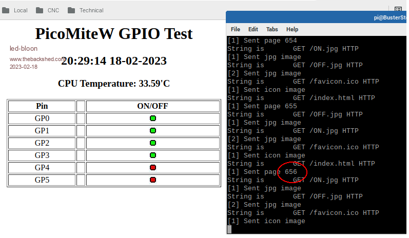

led-bloon
Joined: 21/12/2014
Posts: 210
Posted: 09:39am 18 Feb 2023
BIG PROGRESS! Not overnight yet, but doing great.
Thanks Peter...
2 browsers hitting it.
led
