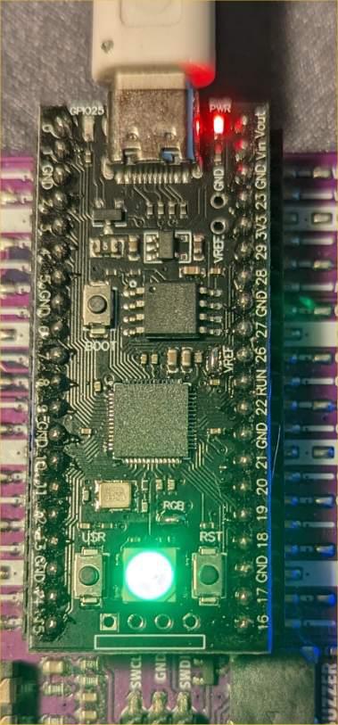

Posted: 10:31am 21 Jan 2023
  Tinine said
Nice module
Craig
<A couple of updates - (UK time) 13:36, 15:00.>
<More updates 22/1/23 09:12, 11:10>

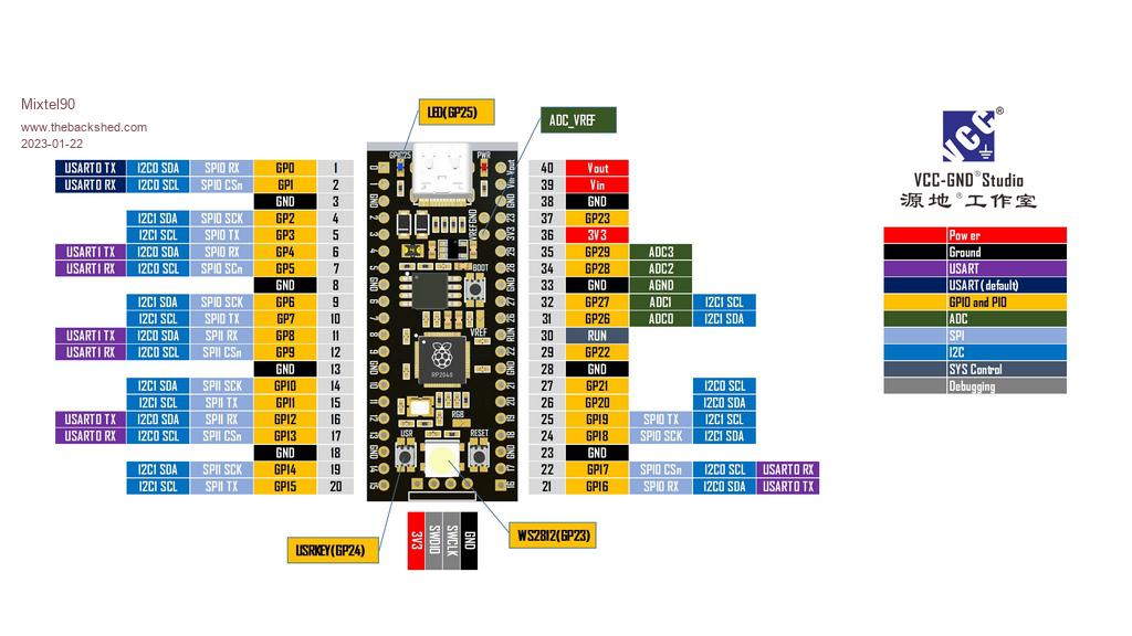

I've just got a few of these (16MB version) from Ali Express and they appear to be OK. Note that they are NOT 100% compatible with the Pico, but for my purposes that doesn't matter. Here are the differences that I've found:
* The micro-USB connector is changed to USBC Hooray! :)
* The SMPS has been replaced by a 3v3 linear regulator (ME6215). Beware the dissipation limit of this (250mW). This limits the *total* current to about 140mA from a 5V supply. This is to power both the PicoMite and any external loads. It also means that the input voltage must be at least 3.7V (at 200mA load) to be safe, a little lower at lower load. Not recommended for battery operation.
* You can't disable the on-board SMPS as it hasn't got one - and there's no need to anyway as the major noise source has gone.
* The 3V3EN pin becomes GP23, which is also connected to the WS2812 LED (if enabled - see below).
* The ADC reference pin is on an additional 2-pin connector with a GND. The original VREF pin becomes ADC3.
* VREF is floating and does not default to 3V3 unless you close a zero-ohm link, in which case it is directly connected. You could fit an 0603 size resistor here for more flexibility.
* GP24 is connected to the USRKEY button. If the schematic is to be believed it pulls GP24 low via 10k. You can't use it to detect VBUS. (VBUS is no longer available on a pin).
* VIN (pin 19) and VBUS from the USBC socket are connected via schottky diodes to V+ (Pin 20) and then via a fuse (unknown rating) to the regulator. VIN and V+ won't back-feed to the USB. V+ won't back-feed to either supply.
* The WS2812 is disconnected unless you close a zero-ohm link. Once you do that, it's type "O", not type "B" and is on GP23.
* The SWD connector now includes 3V3 so it's got 4 pins.
The board is supplied with a 90-degree pin header for the SWD and the two 20-pin male pin headers. The Heartbeat LED is blue, so it's an obvious upgrade. :)
This board doesn't have castellated connections so it's not suitable for surface mounting. :(  On the other hand, the connections are silk screened on both the top and the bottom of the board.
Currently running 5.07.07b7
Loaded first time.
Have had no reconnect problems when reset or disconnected when using Tera Term.
I've not been able to get the first sample to run at over 210MHz (non-VGA firnware).
I've looked at the possibility of using this on the PicoGame and it appears to have no problems. Simply configure the board as if you were using the SMPS and don't fit the regulator. This will mean breaking the 3V3EN link under the board.
As it comes, pin compatibility isn't all that bad.
The debug connector is the only real layout change.
All ground pins are in the same places.
Don't ground pin 37 (3V3EN, now GP23)
Feed 5V into pin 39 as usual
Get 3V3 out of pin 36 as usual (albeit at a slightly lower current)
Connecting a LM4040 between pin 35 (VREF, now ADC3) will do no damage, but won't do anything else either!
The only difficulty is if you want to use VREF. It's more awkward. You can always feed a reference voltage into ADC3 and use that to scale other inputs though.
Circuit diagram: YD-2040-2022-V1.1-SCH.pdf
Edited 2023-01-22 21:14 by Mixtel90
Posts: 6626
Posted: 02:26am 23 Jan 2023
  Quote  I've just got a few of these (16MB version) from Ali Express and they appear to be OK
Mine arrived today so your post was timely.
My attempt at CPUSPEED 250000 also failed.
I haven't tested all options but when I ran this program at 200000, the led flashed green bright once per cycle.
at 133000, the led flashes white.
With the faulty line of code changed to the commented out line, both speeds were the same.
Because of the difference in operation at 200000, I will treat any speed increase with caution.
DIM b%, n% =1, k% = 1
SETPIN GP23, DOUT
DO
BITBANG WS2812 O, GP23, 1, b%
PAUSE 300
b% = RGB(n%,n%,n%)
n% = n% + k%
IF n% >= 32 THEN k% = -1
'if n% <= 1 then k% = 1
IF n% = 0 THEN k% = 1 ' this is the faulty line
LOOP UNTIL INKEY$ <>""
BITBANG WS2812 O, GP23, 1, 0
I added a flying lead to the WS2812 instead of closing the link so I could use any IO for it.
The same abnormality is observed when using another IO pin sometimes resulting in a different colour.
Edited 2023-01-23 12:27 by TassyJim
