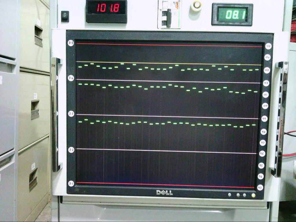

Posted: 09:42am 05 Nov 2021
  Quote  Did you actually have a voltage mishap, that you know about?
No perfectly normal operation one day, the next day zero volts across one of the cells.
I mean truly zero, not even 0.1mV measurable.
This is an old picture from Jan 2019 showing how I monitor the voltage of each of the 30 cells continuously. Upper and lower readings are the max and min voltages ever reached. Middle trace is real time cell voltage.
One day perfect, next day middle and lower traces of one cell completely gone, right off the bottom of screen.
The cell just spontaneously shorted out.
The other Forum member that has had this shorted cell problem is using much larger Winston cells.  So its definitely not limited to one cell size or one batch.
Edited 2021-11-05 19:45 by Warpspeed
