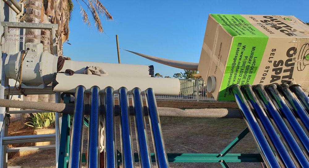

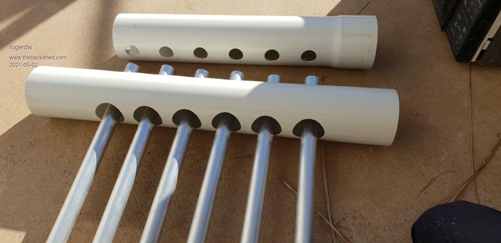

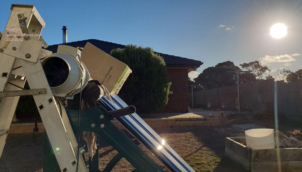

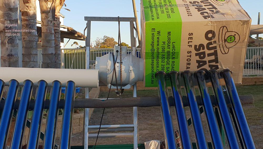

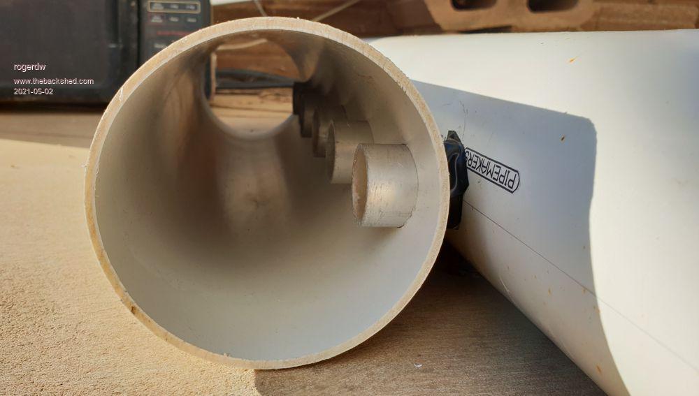

Time for an update.
I've been experimenting with various setups and plan for more tomorrow.
The following picture is a bit messy but is actually two separate experiments.
The one on the right has 6 tubes venting into the bottom of the box and with the cold air inlet on the bottom left.
Warm air is meant to rise to the top and be pushed out on the top right hand side.
The inlet tube goes all the way across and has holes in the side facing downwards.
The idea was to try and limit the colder air from mixing immediately with the warmer air  ...  and hopefully flow into the tubes as the warm air flows out.
Doesn't really seem likely to work  ...  but I've based it on the fact that many of the cheaper, more basic water heating systems have the pipes directly into the tank  ...  and as the water is warmed in the tubes, it rises into the tank  ...  being replaced by cooler water at the bottom.
From some of the literature I've read  ...  the water heating systems that use heatpipes are between 15-20% more efficient than this basic system  ...  so this should work at least to a degree.
The fan is a 2 speed inline exhaust fan that draws 30 watts on low at 467 cubic meters/hr  ...  and 60 watts on high at 552 cubic meters/hr.
I had just got home from Bunnings last weekend where I looked at various fans etc  ...  sat down with a cup of coffee and was checking out FB Marketplace  ...  and in the top row were three of these fans  ...  for $50 the lot. Two 6 inch and one 8 inch. Needless to say I jumped on them quick smart.

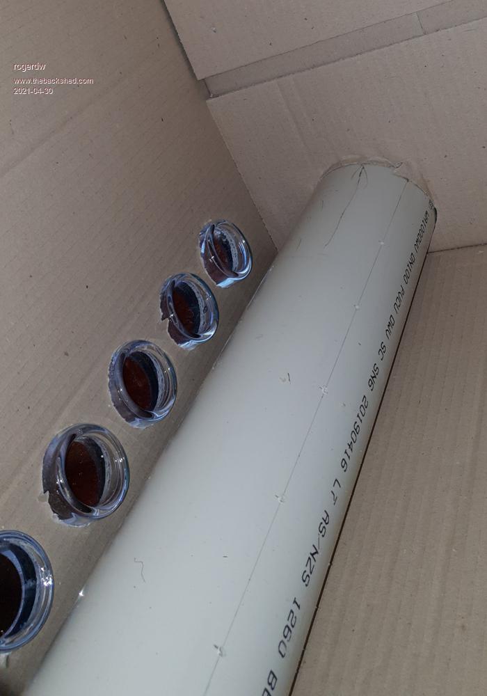

This next photo shows the view from through the warm air outlet.
You can see the tops of the evacuated tubes  ...  and the cold air inlet tube, though of course you can't see the holes in the bottom of the tube that spread the cooler air across the bottom.

I should probably give some figures so you can see what sort of results I've seen so far.
In the photo above with the cardboard box  ...  I was replicating an air version of the water-in-tube heater.
I blocked off the vents and after about half an hour had 62 degrees at the top of the box  ...  ambient was about 25 degrees.
Later I fitted the fan in place  ...  ambient 25.5 degrees  ...
This time, with the inlet and outlet both open  ...  the temp in the top of the box got to 42 (after half an hour or so).
I was using a dial thermometer with its stem just poked through into the box.
12.40 pm
Turned on the fan  ...
2 mins and temp inside top of box down to 35
4 mins down to 30
17 mins still on 30  ...  ambient still 25.5
So, 4.5 degree gain.
Later I started using an IR thermometer facing into the outlet  ...  and that seemed a couple degrees higher than the dial gauge stuffed through the side of the box  ...  but I have no idea of the accuracy of them all.
1.10pm
26 into fan inlet (IR thermometer)
32 coming out
2.00pm
26 into fan
31.5 out
Bear in mind, this was a nice warm day with reasonable sun  ...  25-26 degrees
I could probably try a dozen different things around this setup  ...  but my plan is to build a setup with tubes going down into the glass tubes to blow the hot air out  ...
I should be able to run both systems at the same time to compare the different methods  ...  that way it will be easier to see which is the better process.
I'm kinda leaning towards the central tube idea being more efficient  ...  but only one way to find out.
If it is markedly better, I will then start playing around with different versions of that.
Once I have something that seems reasonable  ...  I will put all 18 tubes into the stand and place it at the side of the house facing north  ...  and just pipe the air out of a temporary vent in one sliding window and back into the next.
Don't sweat, I have approval  ...  but I couldn't get an ok on blowing the air under a mat  ...  not sure why that's an issue  ...  but she's not home 24/7  ...  so I'll still have a shot at it.
It seems reasonable to expect that 18 tubes should be able to collect 3 x the heat of just 6.
If I feel that it is worthwhile  ...  my idea is to join two frames together and have 36 tubes laying on the roof. Perhaps draw the air out of the passage  ...  and pipe the return into a colder area of the house. In fact, I can't see why I couldn't join 3 lots together for a total of 54 tubes though that may be overdoing it. Just needs a longer manifold.
Obviously going to need some smarts to control it as well. No point getting ahead of myself.
Cheers,  Roger

Okay  ...  so I have to admit I've been more than a little underwhelmed with my results so far.
Anyway, my next experiment is with tubes down the centre of the evacuated tubes and push the cooler air down through them to push the warm air out of the tubes.
Pictures are easier than explaining  ...
I must also say I love my new holesaw set.
Here's a view in the cold inlet manifold  ...  the other end is now closed so the air must go down the tubes.
Here's a view of this setup with the 6 tubes on the left.
I only started this at 4.00pm this arvo and the sun was already way off to the side. This photo was taken at 4:15pm.
Okay, the tubes had been in the frame and in the sun all day so had gained a lot of heat inside  ...  all between 165-170 degrees.
I assembled my manifolds and tubes and inserted them into the evac tubes.
The tubes are all probably a foot too short  ...  but they only cost me $2 each  ...  so I wasn't going to complain.
While I was fitting the fan, one of the tubes fell through to the bottom of the glass tube. Lucky it didn't break. So all these figures are with only 5 tubes not 6.
Ambient was 21 degrees
Turned on the fan at 4:08pm and outlet temp went steadily up to 71.4 degrees C.
4:10  ...  80.4  ...  ambient 21
4:15  ...  70.6
4:27  ...  52.8
4:32  ...  44.6
4:50  ...  28.7  ...  ambient now 18.7
5:05  ...  22.4
(Had visitors so a little hard to stay on track!!!)
I have to admit, this has me a lot more excited than all my previous experiments.
Considering the sun was already low in the sky and way off to the side, I'm amazed at the heat that was pumping out  ...  and for how long it pumped before it dropped right down
Am really keen to see what it's like in the middle of the day when the sun is at right angles to the array  ...  and just how well the sun recharges the tubes  ...  and how long the array can maintain a useful output.
Again, the fan was on low speed  ...  30 watts and 467 cubic meters/hr  ...  though it is a 6 inch fan pumping into a 4 in manifold in this case.
I think it's safe to dismantle the previous array, these new results feel a lot more worthwhile pursuing.

That's a really impressive piece of hardware you have built there Roger, very nice
I have been thinking about how to take some measurements from it.
One instrument you might find useful would be a low cost digital anemometer, I bought one many years ago from Dick Smith electronics, but they are also available from e-bay and Ali.
The one I bought measures in several different units, but feet per minute, is very useful for calculating flow in any given pipe diameter.
I used it to measure airflow from one of those 100mm diameter 12v bilge blowers, and surprisingly the figure agreed exactly with the bilge blower specification, so it is useful information to have.
The one I have also displays air temperature, which they probably all do.
https://www.ebay.com.au/sch/i.html?_from=R40&_trksid=p2380057.m570.l1311&_nkw=digital+anemometer&_sacat=0
The other idea is a way to measuring the actual heat output.
If you could fit an electric heating element to the hot air outlet, and adjust the electrical power so that the final total temperature rise was exactly doubled, the electrical power input should then be equal to the solar power input.
Again a cheapy e-bay plug in ac wattmeter might be the easy way to do that, along with a variac which I believe you already have. Just subtract the no load idling power of the variac from the final power reading, should be simple enough.
The bare heating element from a fan heater might be pretty ideal. Should be able to buy a dead one from the local rubbish tip for a couple of dollars.
With fairly simple basic equipment it should be possible to record some rather useful numbers.
