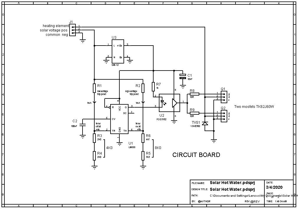

Hi Mike,
I may have misunderstood what you are saying with that circuit, but due to the frequency of the switching, I was thinking to eliminate the relay all together.
Can't see it doing the suggested frequency of up to 100hz and I doubt the thing would run much over 10 hz anyway. Of course if it did, I imagine it would wear out pretty quick even if they are rated to 10M cycles as I have read.
My idea was to remove the relay and replace it with a mosfet or an SSR.
I have been looking at different sites and there are a lot of different board that would work all the same way. I'm thinking that an external box could be added that was premade with the voltage divider the cap bank and the SSR already configured. all one would need to do would be connect the wires to the board and tap off the relay drive side contacts. If the relay fell over in time, no problem.
Of course now I have figured this out, I'm thinking of how to do it with an arduino. In looking at that I'm coming back to simple ways to build these from components as everyone here advised in the first place.

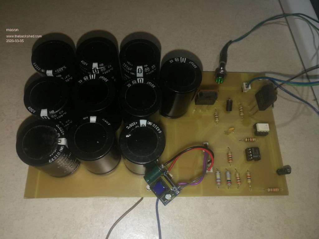

I'll get the boards up and running first. Hanging for a delivery of the boards I have ordered.  Everything is saying orders from China may be delayed.  Got some voltage regulators in a week on Friday,much faster than usual so hoping everything else follows suit.

Dave,
I plan to order a big bunch of boards (for five different projects) from China in about a weeks time, it appears most of the Chinese are now back at work.
I will include a minimum order of five "Solar Hot Water" boards with that. With combined postage, the extra cost will be minimal.
It will be the exact same circuit as shown at the beginning of this thread, and it will drive two parallel mosfets at any speed.

Dave,
That generic mosfet circuit was to provide a higher current than the PCB relay could provide, but if you are switching 10-100 HZ or higher rate then the relay has to go, it wont last long.
I would take up Warp's offer, it will be a better engineered solution than messing around attempting to Hodge bodge (is that the term) off the shelf modules.

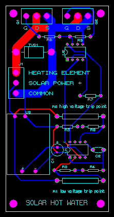

I only completed the circuit board layout for this yesterday.
But now have Gerbers that I can send out for free if anyone wishes to e-mail me.
Has to be e-mail, I cannot attach anything to a PM.

I have thought about this "dc burning the thermostat" issue.
The problem in interrupting high voltage dc, is that it can start up a continuous plasma arc which just keeps going, which can melt down just about anything in seconds.
But this system works on PULSING dc, which only lasts a very short time during each discharge part of the cycle. The heating element gets disconnected by the mosfet so the big capacitor can recharge. If it cycles reasonably quickly, I just cannot see arcing being a problem.
While the thing is cycling, I very much doubt that an arc can last long enough to do any damage, and when the mosfet turns back on the thermostat contacts will be open.
None of this has been tested or tried.  Its all just a hypothesis at this stage.
I can see a problem though, if the system is overpowered with too many extra panels in mid summer. The system may stop cycling and turn on continuously because the voltage never falls to the low voltage switching off set point.
If the thermostat then opens, it could go Supernova
I suppose it would be possible to disconnect any extra panels through mid summer, as they will not be required anyway. Then connect them back up when the system starts to struggle a bit.
Dave,
What I planned to do was order five boards and fit all the parts for testing to just one board, then send you that with a couple of extra empty boards.
You can be "Forum Guinea pig" to prove that it actually works and give others here some confidence in what is still something that has not been fully tested on a real system.
Its easy for me to do because I designed the thing around parts I already have here and am very familiar with.  Anyone else would have to scrounge all the various bits and pieces which can be a bit frustrating and take time.

Dave,

If its cycling at a few hundred, or a few thousand Hz, Arcing is not going to be any worse than if powered from the 230v grid.
Its only if the system ever stops cycling due to there being a lot more solar than there is load. I think it should be pretty safe to power the system right up to the full heater element rating and possibly a bit more.
Someone, I think it might have been Mike, suggested using the original thermostat only as a backup, and using a commercial temperature controller to drive a solid state relay to switch bulk power on and off to the whole system for temperature control. That would also provide a nice digital display of tank temperature.
If that were set to a few degrees lower than the existing thermostat in the tank, it would take over all the switching and temperature control.
I think I would rather just supply Gerbers to people rather than mess with money and postage myself. That way the Gerbers can be copied, shared, and distributed to a wider range of people and the whole thing is then right out of my hands.
The two inch by four inch boards are not expensive, and the cost of the actual boards (from JCL) is $3.03 for five boards!  Postage is the killer though, about $10 to $30 depending how you go about it, and how urgently you want them.

I just now ordered a big stack of boards for several other ongoing projects, and the extra three dollars for the five small "Hot Water" boards really made no difference at all to that. So they may all get here around the middle of next week perhaps.
Anyhow, lets just see how far all this takes us.
Have a play with it, build a few for your friends, you can have all five boards and tell us what the results look like.
If you can sell a few more, good for you ! The Gerbers will be public domain and free for anyone.

Posted: 04:24am 05 Mar 2020
I'm very surprised the idea behind it hasn't been thought of before. Shows the calibre of the people here that came up with it!
I think I'll do a bit of initial testing loading the things right up and then try to put it in practical use.  I can put the 50L heater as a preheater on my main tank and see how that goes in real world conditions. I'd expect it to be emptied every day so should be a good stress test and give some clue as to how effective it will be.

Posted: 01:18pm 05 Mar 2020
Here is my WarpsHotWater circuit, have not tested it with solar panels, only with 120v power supply seems to work.
Posted: 09:14pm 05 Mar 2020
Great work there Mason
This is the artwork for my own two inch by four inch board:
Posted: 10:56pm 05 Mar 2020
Here is the parts list:

R1,  R2     One watt carbon resistors to suit system voltage as discussed in thread.
R3,  R4     2K0 metal film
R5          3K3 metal film
R6          4K7 metal film
R7          1K0 metal film
R8,  R9     10R metal film.
Mosfets Q1 and Q2 will require an "adequate" heatsink, which in turn depends on the mosfet type chosen, its rdson and the amount of current.
