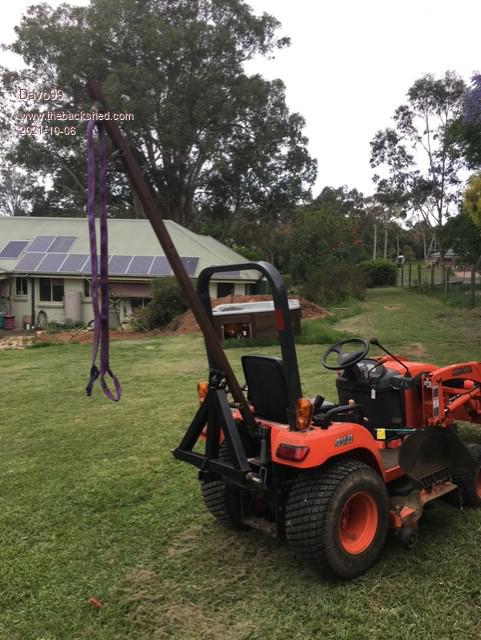

Might look at packing up the ground mount array.  Working on doing a retaining wall for the outdoor bathroom and it's in the way. The naturally occurring longer daylight will make up for the lower input and I'll try to get them on the roof however finding an offsider for assistance just bringing the panels up is proving problematic.
For some strange reason my daughter seems to have taken a dislike to assisting with panel installation. Funny girl, you think shed be champing at the bit for the opportunity to do something like that but what can you say? Kid's these days "eh??
Not sure the wife can be much help.  She's always been shorter than a panel and now shes lost so much weight, she's barely the weight of one.
Bit much for to handle at the best of times and if one gets a bit off balance or a breath of wind comes up... Outcome will not be memorable for good reasons.

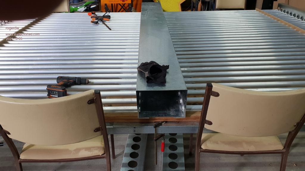

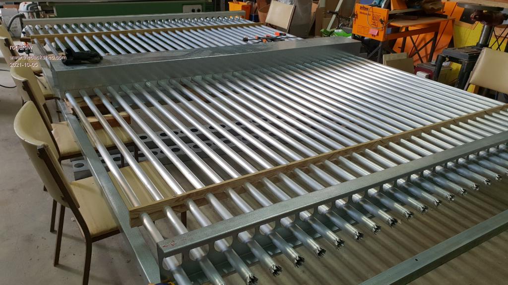

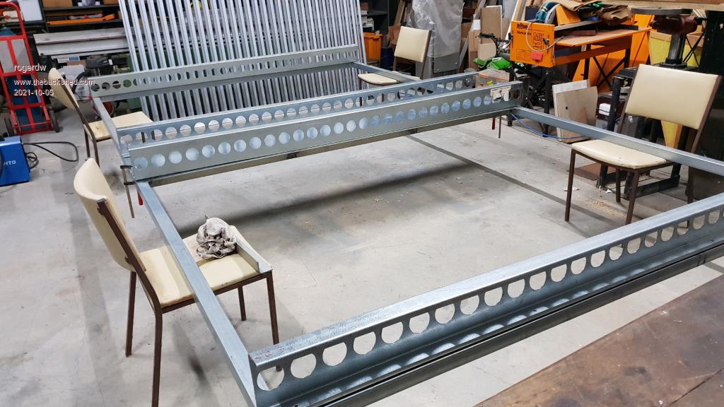

Well I finally did a bit more work on this device.
I marked out and drilled all the holes for the c-section beams to bolt to the main frame.
I lined up all the tubes and fitted the cold duct cover and in the process discovered that the angle had bowed up in the middle from overheating during welding.
So I braced it all with timber, put a block across the top  ...  and wacked it with the sledge hammer.
Whoops, a bit too much strength  ...  and it was then bent the opposite direction about an inch and a half. A bit of gentle levering with the crowbar soon had it staight.
Despite being 60 x 60 x 6mm angle, it is surprisingly easy to bend.
I drilled all the top cover holes which was difficult because I had to reach way over into the middle, but I got it done. I was nearly going to do it before I welded in the tubes, but a friend warned me that it was likely to warp  ...  so I'm glad I left it till after.
I have to chase up some foam suitable to insulate the inside of the outer, hot duct  ...  probably about 50mm thick  ...  and able to cope with lots of heat over summer. Anyone have any recommendations?

  Quote  Despite being 60 x 60 x 6mm angle, it is surprisingly easy to bend.
Heating it up to do the brazing has annealed the aluminium. It will be very soft and bendy, but over time it will very gradually recover and become stiff again.

Seeing it all laid out with the chairs for reference, really does put into perspective what a Sizeable project this is!
It's quite an undertaking Roger and a huge credit to your drive and ingenuity with it.

Posted: 10:49pm 05 Oct 2021
It certainly did get hot in the brazing process, so not surprised it affected it somehow.
It shouldn't be too much problem because they are all screwed together with the base and the duct cover  ...  and there's no weight or stress on the tubes hanging out. It will definitely continue to get hot, especially during our long summers.
  Davo99 said  Seeing it all laid out with the chairs for reference, really does put into perspective what a Sizeable project this is!
Thanks Dave, and you're right it is a big project. Certainly takes up a lot of room in the workshop.
I have been wondering if I should consider assembling it fully except for the glass tubes  ...  then hiring a crane to lift it on the roof. I have a friend with a telehandler that extends out about 50 feet  ...  except he's half an hour away.
Anyway, I still need to finish the assembly before I worry too much about it. And too many other jobs getting in the way. Now with daylight saving I already spent 2 hours on the tractor with the slasher after work last night.

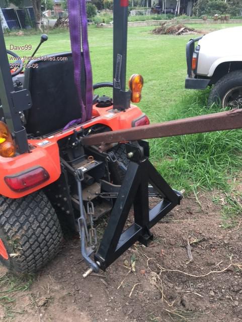

May have mentioned it before and if so forgive my poor memory.

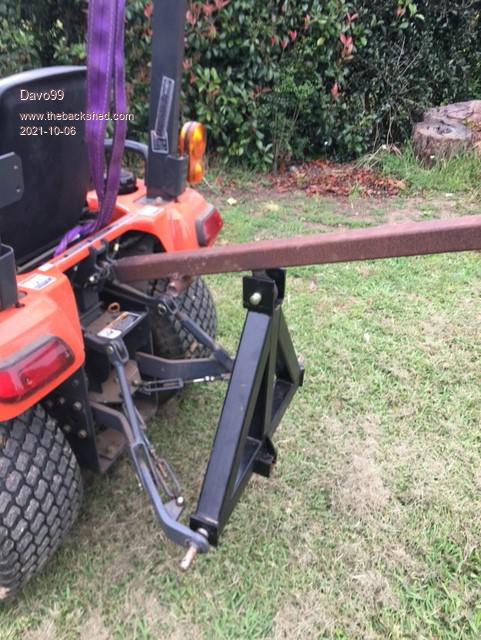

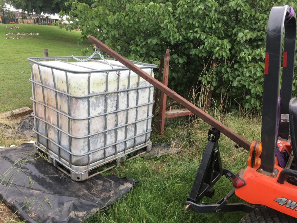

Could you make up a simple Jib Crane for your tractor? Really all you would need is a Good length of  square Tube or maybe even Timber.
You just replace the top Link on the 3 point hitch with the beam which extends out the back.
I think your tractor is a pretty decent size and the Frame for the heater would probably be under 100 Kg I'm guessing, so you should be able to hang it right out the back and get good lift and reach.
You can get the beam near Vertical so as long as you can get reasonably close to the house,  You should be able to get it well up there.  You would probably only need to get the front edge up then you could release the frame and just slide it over the edge and into position.
Some 40x40x3 or thicker should do it and you could go 3, maybe 4M long.  I put ball ends on mine for where the pins go but I wanted to use mine regularly where as you could just bore some holes  for the pins for an occasional one off.  You wouldn't need a frame like mine, probably just leave the slasher or blade on, whatever you have and replace the top link with the jib.
You might even just raise the jib then pull a rope though the end to manually lift the frame then you can release it to lower into position.
I'd use this for lifting solar panels only I can't get  very close to the house because of the retaining wall but it sure would make things easier!

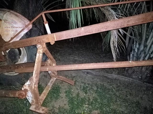

Its abit dark outside but this is a lifting jib made out of junk, it needed bracing for extra strength, its connected to a David Brown 990, hydraulics will cutout before bending something, post hole borer on at the moment.
BTW the hydraulics on the DB and other tractors are just on off when lifting, can be fast and violent at the end of the jib.
Used an Excavator to lift most of the things, made a forklift attachment onto a quick hitch.....lifted a lot of solar stuff on to the roof.
Cheers Aaron

  Revlac said   it needed bracing for extra strength, its connected to a David Brown 990, hydraulics will cutout before bending something,
Mine is  about 5MM so pretty thick. Just what I had around at the time.  haven't bothered bracing it because like yours, My little toy tractor gives out before anything has bent.  At the end it will lift a full 240L plastic drum and maybe a little more but that is about it. I also have a lifting point about 2/3rd from the end and it lifts a lot more there of course.  The max I have picked up with it was about 400Kg and that's plenty of component loading for this little thing.
  Quote  BTW the hydraulics on the DB and other tractors are just on off when lifting, can be fast and violent at the end of the jib.
Yeah, that sounds hairy.  Dads new little JD 1025 has a height setting on it. You move the lever to a certain position which you can lock off and pull the lever back and that's where it goes and stays every time.  Mine is just an adjustable speed control. Keep going till you let it go unlike the JD ( and usually bigger tractors) where you pull the thing all the way back and it goes so far and stops.  Useful feature.
I have the 3 Pt lowering speed control.  Quite handy when I am picking up something like a load of solar panels.  Can screw the valve in and then hold the lowering control and crack the valve so the 3 Point is lowered slow and Gentle.
Of course the stupid people then go and try to lower a load a fraction of the weight and wonder why the thing isn't dropping at all or taking forever.  Glad I have never done that...... more than about 50 Times.  Just reach down and adjust the controls and all good. Wide open the thing will hit at the speed gravity takes it.
  Quote   made a forklift attachment onto a quick hitch.....lifted a lot of solar stuff on to the roof.
I made some forks for the 3 Point given it's far greater weight lifting.  Won't lift very high, maybe 400mm but plenty for a pallet or machinery.
I want to do some forks for the Bucket.  I'll do them clamp on style.  Won't lift much more than about 250KG on the front but that will do.
I am going to shim up the Hydraulics so I get  greater response with the loader and it should  lift another 100KG easy. That would be quite handy not that I will stress the machine with it too often.

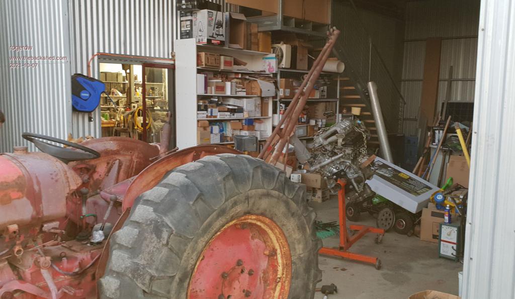

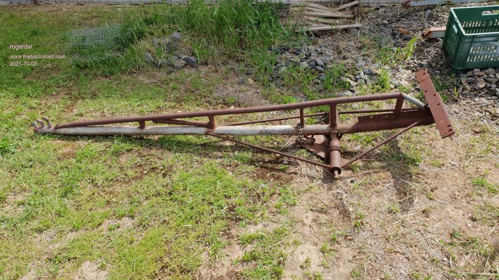

I do have a jib, but can't really get close enough to use it. There's a fence in the way and then not much room to the boundary.
Looking like I'll just slide it up bit by bit and with an extra hand or two should be easy enough. As long as I'm not silly enough to try and do it by myself.
All a bit old and decrepid (like me)  ...  but it still works ok.

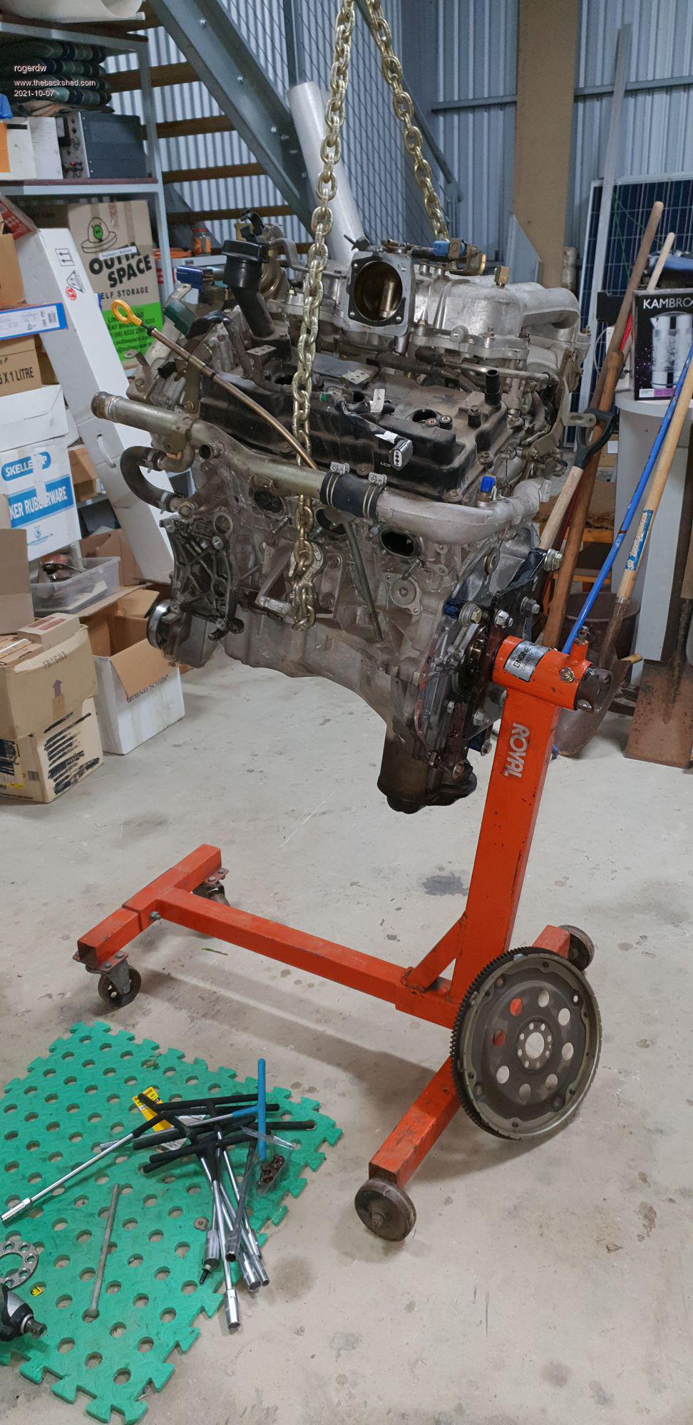

I dunno what it weighs but the hydraulics lifted it ok. A V6 Nissan motor out of my wife's van.
Cheers,  Roger

Posted: 04:07am 07 Oct 2021
Did it get hot or did the oil light come on and she just wanted to get it home?
Would weigh about 200KG.
I imagine that old thing would lift easy double that, probably over 500 with no problem. The old tractors did what they could and far surpass the new ones of the same size that are severely restricted by all sorts of OH&BS.
Dads old tractor will lift over a tone in the bucket. We looked at a new one and  they are no where near as strong which was a big surprise. Would have to be nearly 3 times the machine  to lift the same which makes it a big and expensive unit.
Looks like a nice Classic Tractor!
