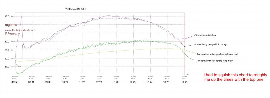

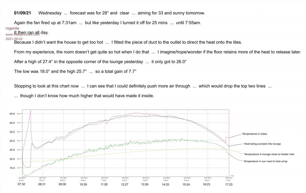

Morning all  ...  I forgot to post this last night.
Was certainly a very nice day here for the first day of spring.
I had put the extension duct on the outlet so the air blew straight onto the floor tiles for the day. The overall room temp max was a bit lower than the previous day.
Our forecast for the next few days are (today 33) then 17, 16, 16, 18  ...  so I'm keen to follow Dave's suggestion and get the place as hot as possible today to carry us through.
I didn't bother relighting the fire last night either for the first time in several months  ...  though I plan to tonight so we don't lose too much with this next cold spell.
I heard the fan fire up earlier again today at 7:22, so I got up and switched it off until I'd had my shower etc. Switched it back on at 7:48.
Cheers,  Roger
Posted: 11:33pm 01 Sep 2021
That is a very solid twenty degree rise, very impressive.
More air will always be better for heat transfer, especially so when the larger system is finally up and running.
Aiming the airflow down at the floor is o/k, but what you really want is for the air to blow horizontally right at floor level directly across the floor.

  Warpspeed said  That is a very solid twenty degree rise, very impressive.
Thanks Tony.
Yes agreed about the airflow. Just at the moment the 50 watt fan is a bit light on, but the 400 watt one is overkill  ...  plus a lot noisier.
I just stretched out the piece of ducting some more  ...  and now I have it blowing horizontally across the floor. Thanks for the suggestion
I did measure the tile temps around 11pm last night  ..  and also did the bare feet test.
The tile in front of the heater was at 24  ...  though the heater had not been fed since 24 hrs before.
The tile that the hot air outlet blows on in the lounge was at 22.7  ...  while adjacent ones were at 21.3.
Very little difference from the hot air  ...  though it was 6 hours since the hot air shut off  ...  and believe it or not   ...  the 21.3 tiles felt cold to walk on  ...  but the 22.7 was quite comfortable to stand on.

Here's todays results after a forecast of 33, windy and partly cloudy.
It did get uncomfortably warm inside  ...  but being aware the cold change is due tonight meant it was easy to put up with  ...  plus all in the name of science.
I think I mentioned I didn't relight the fire last night either  ...  though I plan to do it soon, only because we know the temp is supposed to drop significantly for next 3 or 4 days.
EDIT: I should also mention that it's 10pm and still 23 degrees here in the kitchen.
