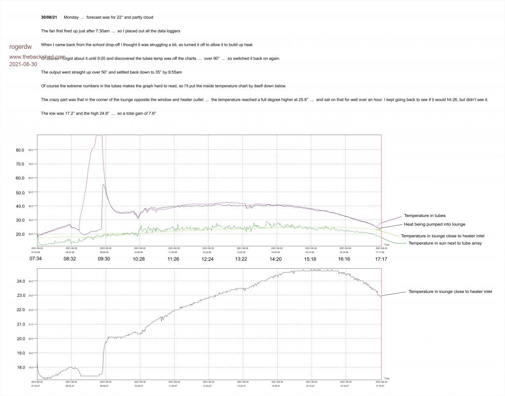

  Warpspeed said  It should be possible to just leave it switched on 24 hrs, and just let the differential controller do its own thing. No need to let the tube temperature build up initially, that is just wasted heat.
If its 13.7 inside and its pumping 19.5, that is still heat gain, which will then rapidly increase as the sun rises. It will likely cycle a few times by itself initially if it needs to, but just let it take care of itself.
If it ever does start pumping continuous cold air when its freezing outside, adjust the controller settings up a bit.
Yeah, that is what I've been doing ever since I've set up the differential controller  ...  it was just yesterday being so cold that made me think if I left it off for even 15 or 20 minutes it would have time to rise 20 or 30 degrees.
I'm a bit concerned that once the big one is up and the outlet blows into the more lived area, that there may be some resistance to having 19 or 20 degree air blowing in  ...  and to wait just 15 minutes to avoid that, may still be a good idea.

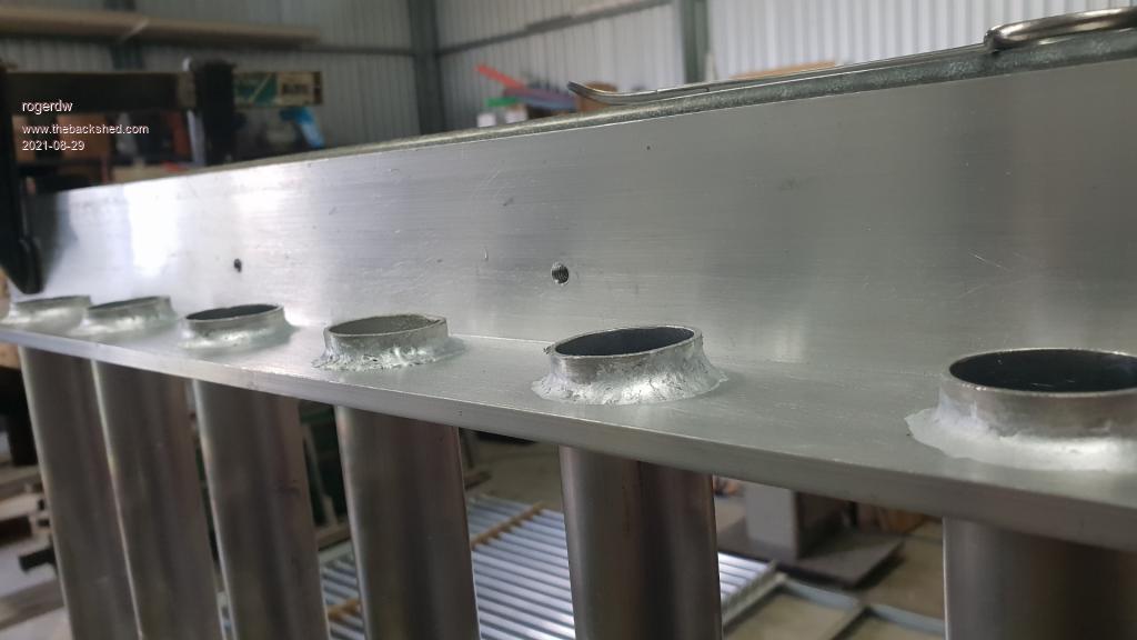

Those brazing rods are really good, but like many things these days, there is a lot of fake crap out there. Plenty of horror stories on the internet about e-bay bargains.
The proper rods melt at a temperature far lower than the melting point of aluminium. The fake rods have a higher melting point, and are probably just very expensive aluminium filler rods !
If you buy from a respectable tool or welding company, American, Australian, or European, they should be o/k.
The ones I bought from e-bay were called "HTS-2000" and worked very well.
I also have an ac/dc MIG plus argon, but its sometimes difficult to get right into very restricted corners with the arc. The arc tends to jump away from where you want it to go.
On the other hand, the brazing rod can be poked exactly where you wish, into a very confined space, once the whole thing is sufficiently pre heated.
The secret seems to be scrupulous surface prep using fresh new aluminium, and you cannot really go wrong.

  Warpspeed said  Those brazing rods are really good, but like many things these days, there is a lot of fake crap out there. Plenty of horror stories on the internet about e-bay bargains.
Yes, exactly the conclusion I had come to. With the dud rods, I ended up with the aluminium so hot that I was poking holes through it with the rods as I was trying to make them melt.
When I first tried the ultrabond rods from Hampdon.com.au  ...  it was obvious they were melting at a much lower temperature. I could see the effect just like shows on their youtube videos.
  Quote  On the other hand, the brazing rod can be poked exactly where you wish, into a very confined space, once the whole thing is sufficiently pre heated.
Yes, that part is handy  ...  being able to poke it into any tight spots.
I think what surprised me the most was when some ran through a gap  ...  a couple inches down the outside of a tube.
I figured it would just break away  ...  like solder does when it drips down something  ...  but this stuff was bonded well and truly  ...  and it was way down onto a section that I hadn't cleaned.
For me, the secret seems to be in getting the whole area really hot  ...  not just a square cm at a time like you do when using an oxy. I was blasting the whole area I wanted brazed  ...  melt some on  ...  heat some more  ...  then finish the job.

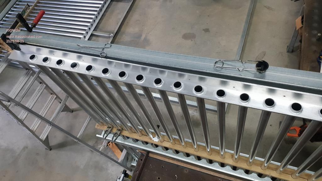

I set up the second bank of 30 tubes today and had them all brazed in in under 2 hours. Very happy with how they turned out.

Posted: 12:41pm 29 Aug 2021
Very nice indeed Roger, that will be very strong too.
As Dave says, the braze will completely fill the joint, no need to do the other side.
Looking at this pic on it's own with no insight, one Might be forgiven for thinking you were making a shark Cage, a flash set of bars for a Prison, The worlds largest towel heating rack or a ladder for fat, wide people with little feet. Doesn't look like my boots would fit through the gap in those rungs. The width might be appropriate though.
Again, VERY neat and professional looking mate. Shame you have to hide it.
Even though it's ally, It will have a fair bit of thermal Mass.  What you were talking about before with the fan pushing 20o air, I guess you could just  turn the thermo up so it moved the differential. If the  start up is delayed, going to be pump ing warm air for a while with the energy stored in the setup that's for sure. Being ally the thole thing will hear up... Which may be something to think about with insulating it as well because the cold will also will really soak it the wrong way and you will bleed energy to atmosphere as well when it is warmer than the atmospheric temp.
As Tony says, any input that's higher temp than what is inside is an improvement and will raise the temp. Perhaps it may be better to blow the air directly up so the warm air in the room is forced down to where  you want it and circulated. It will feel most cold when directly hitting a person so if you reduce the felt air movement, may be better.

  Warpspeed said  Very nice indeed Roger, that will be very strong too.
Thanks Tony. It certainly feels strong enough  ...  and will be good not having to pour all that heat into it again to do the other side.

I haven't posted any charts lately so thought I'd throw one up. I did try turning it off this morning for a while to let it build up more heat, then promptly forgot to turn it back on.
Certainly performed once I set it going again.
I realise most of you would be turning on the air conditioner if you had it that hot!!

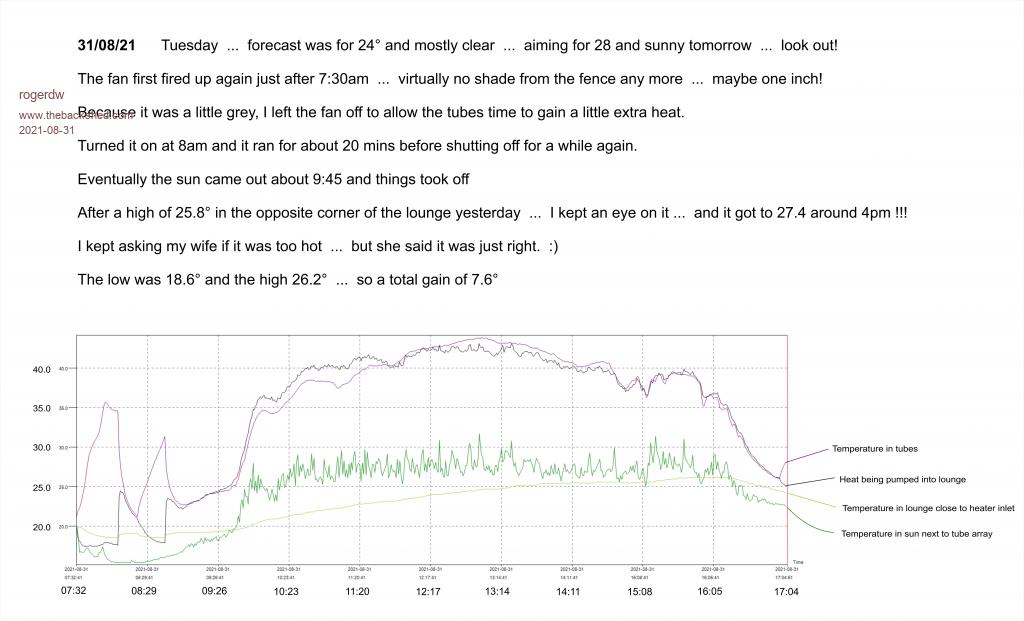

I think I'm gunna run out of time for using the big one this season  ...  it's warming up already.
Forecast was for 24 today, 28 tomorrow and 32 on Thursday!!!  ...  though 17 on fri and sat.
The lounge hit 27.4 today and the wife claims it was 'just right'.
Cheers,  Roger

Though it's already backfired on me  ...  today she musta been feeling that warm she started asking about when I was gunna get the pool going
And now that you've mentioned it  ...  I am interested too to "see what she'll do" on Thursday if it really does make it to 32.
Perhaps I'll fit the duct on and aim it at the floor for the next couple days  ...  I'm sure that limits the room temp a bit, which is fine   ...  and hopefully returns some of it when it cools down in the evenings.

  Warpspeed said  If its anything like Melbourne, its 28 degrees one day and 15 degrees the next.
Probably time to start thinking about a room thermostat to tame the monster.
Haha, yep. Though it's good that she's happy to have it get really hot because it must retain it a lot longer. I have to go back out to the workshop coz it's too hot for me  ...  but just happy to know we're saving lots of wood.
