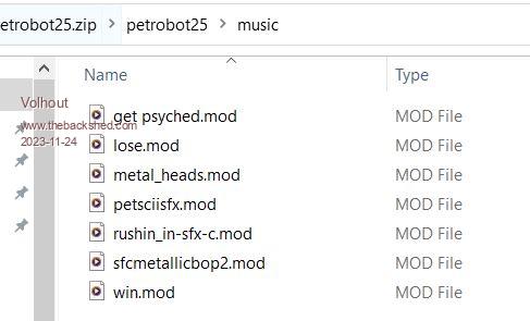

Are you still planning to combine get_psyched.mod with sfx ? Or can it not be shrunk into 128k? There is a larger version you made before (180kbyte).
There is always the option to use the larger MODBUFF.
yes, it's going to be something personal between the MOD and me
  Volhout said
I just checked, but the whole game will not fit on the A-drive (on a VGA it may if we squeeze the hell out of it, but the LCD version has a smaller A drive(last I looked) .. so it will not fit).
even if you save every Flashbuffer together as one File, I dont think that there remains the space to store the Music ..
Maybe a SFX only Version
Edit: I just noticed that you didn't include the pure sfx module in the current package.
was that intentional?

petsciisfx.mod is there, I even included the non-sfx version of get_psyched.mod.
P.S. technically it is possible to "shrink" every level file with 256 bytes...saving 3.5k. The game can be saved "crunched" by MMEdit, saving around 20k.

i was to blind ... did you use the matal_heads mod where i added the Beep in it?
So it can be played by using the menu when selecting an entry.
Edited 2023-11-24 21:54 by Martin H.
'no comment
Posts: 6192
Posted: 11:57am 24 Nov 2023
Good question.
The metal_heads.mod is the same from pet24 and pet23 series.
In the "larger file size" mod files ZIP there was a different metal_heads.
This one:
metal_heads-sfx.zip
Maybe that is the one you need? But it has not been used before. We can add it..
P.S. tried the above mod, and it works.
Edited 2023-11-24 22:13 by Volhout

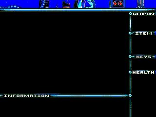

maybe the additional sprit for the banner is to much
yes .. on Game Mite "Rem" out those two lines
first at the start of the Program:
'write frame around playfield
 FRAMEBUFFER Write sc$
 Load image "images/layerb.bmp"  'the actual frame
'----THIS LINE:
 'sprite write #1,0,0 'top of screen showing robot eyes
 If Game_Mite Then FRAMEBUFFER Merge 9
and at the end of the Start menu:
   Pause 50: 'Contr_input$() is to fast to see what position you are in
 Loop
 Play stop
 'save image "images\strip.bmp",0,85,320,16
'----THIS LINE:
' sprite read #1,0,85,320,16
End Sub
if you still want the Banner above, use this bmp
layer_b.zip
Edited 2023-11-25 01:11 by Martin H.

The charm was that the banner changed automatically with difficulty level. There are other ways to fix this if we want, I know. The banner is 320x16=5k pixels = 5kbyte at 1 char per pixel, or 2.5kbyte at 4bpp.
This means that RAM is (very) critical at the Game*Mite. Note that there where only 97 variables when Game Mite ran out of memory. In VGA when running there are 141 variables.
Edited 2023-11-25 01:14 by Volhout
