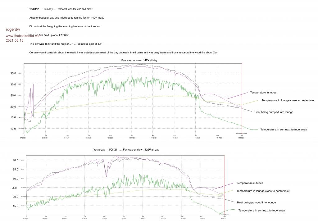

  Davo99 said  The graphs are a bit difficult for me to clearly define but if the green and very squiggly line is the temp of the logger that is in the sun next to the tubes, why is it so erratic, showing swings of up to 5o if the day was clear?
I'd expect that to look like there was a constant shadowing and then full sunlight all day. Is it just a logger anomaly or something else I have missed?
Oddly, where there was an obvious dip due to a large cloud as I take it, the in sun temp  did not vary nearly as much as the tube and output temps.
Interesting observation  ...  and you're right, why does it vary so much?
My early charts until 04/08/21 were with a standard data logger  ...  and with those the temp sensor was inside the plastic body of the logger.
Of course there was a fair bit of thermal lag  ...  which is what's needed for their intended purpose  ...  but I wanted to see a bit more detail  ...  so that's when I fitted new sensors that are really tiny  ...  and therefore much more responsive.
I also fitted those sensors to two other loggers  ...  but I fitted the sensors externally so they'd be really quick acting  ...  and that has worked nicely.
The original loggers, if you took them from say 20 degrees out into the cold at 10 degrees  ...  it would take 20 mins to float down to the actual temperature. Makes for nice smooth graphs  ...  but like I said, I wanted more detail.
Now, they are pretty much a few seconds to get to temperature.
So, all that to say that the sun actually does vary constantly  ...  even with a seemingly clear sky. I've never logged the output of solar panels  ...  but I suspect they should do the exact same thing  ...  does anyone else know???
The 6.8o temp rise is still significant but how did the higher output temp feel? were you in the house enough to make a judgement on comfort level?

  rogerdw said   I've never logged the output of solar panels  ...  but I suspect they should do the exact same thing  ...  does anyone else know??? [/quote]
From what I have seen on my arrays, there may be up to 100W constant variation when an inverter is doing 3-5Kw on a clear day.  That is of course the MPPT doing it's thing but thats a pretty small percentage swing. In overcast conditions the variation is similarly small.
If your loggers have been upgraded to be really sensitive, maybe it's wind or air currents the things are picking up?

  Davo99 said  From what I have seen on my arrays, there may be up to 100W constant variation when an inverter is doing 3-5Kw on a clear day.  That is of course the MPPT doing it's thing but thats a pretty small percentage swing. In overcast conditions the variation is similarly small.
Ahhh  ...  of course  ...  that makes more sense than the sun variation. Maybe I should refit the original to that particular logger.
The reason I did the other two was because I could turn on the fan when the tubes were hot  ...  and while my Owon multimeter would instantly show the temperature coming out the outlet  ...  the logger could take literaly 5 mins to reach temperature.
In that time, the actual temperature could go from 70 degrees down to 40 degrees, while the logger might only reach a maximum of 55 degrees before it started heading down again.
Not so important now that I have the differential controller cutting in and out at much smaller swings.

Would seem then that the setup as it is would be more measuring air temp that sun temp. That's probably why when there was a dip in tube and output temp there wasn't near such a decrease in the sun temp logger.
That's actually interesting in how little the direct sun seems to be having an effect on it.  not sure how you measure  temp in the sun without air temp coming into it as a major influence? Maybe you need the sensor thermally bonded to something like a small plate that's painted black or Mid grey so it's more influenced by radiation than air temp.
Other thing would be a Solar cell and measure the current that produces but that would be measuring light levels I think.
What is the reason for measuring sun rather than air temp?

  Davo99 said  What is the reason for measuring sun rather than air temp?
Haha, no idea  ...  seemed like a good idea at the time.
I think my reasoning was that I was hoping/expecting to see a correlation between the temperature in the sun and the temperature in the tubes.
In fact I was always going to buy a light meter and log the light levels  ...  but I held off because I'd already spent a small fortune on equipment.

Here's todays results  ...  another high if I remember correctly  ...  8.1 degrees
Of course helped by the fact that it was a beautiful day.

  Quote  Here's todays results  ...  another high if I remember correctly  ...  8.1 degrees
I -THINK- you had an 8.2 one day but irrelevant.  With the high you are getting, you are approaching or at as high as you would want to go anyway.
You could get the place warmer for better heat soak but I see drawbacks in that... like the ones I am seeing.
Great to warm the place right up or even be out in the sun as I have been last few days actually working up a sweat.  Problem is, one comes in, Thinks it's Chilly in here then discovered it's warmer than what you have been running the place all winter and thought it was fine.
I was almost blinded yesterday when I went out and saw this intense Reflection.  Thought it was a Mirror fallen off a space craft or something that had landed in the yard but turned out just to be the Mrs and Daughter pretending to be Albino solar  panels laying on the lawn chairs.  Man they are pasty white!
Problem was they came in and were also complaining of the place being cold. Acclimatisation  can work for and against you.  You may get the place too warm through the day then that 8+ degree drop is going to feel icy. They will have you stoking the fire like the boiler on the Orient Express.
The temp rise curve on this heater seems pretty gradual ( can't make out the times on the graph) But you'll certainly hit that a lot sooner  with the big unit.  You may want then to speed up the fan so as to get the heating power without getting too much temp rise or use another damper to mix the air to maintain a set  temp.
This would help  heat soak the place without Slow roasting the Budgerigar and the Goldfish.

Posted: 01:32am 16 Aug 2021
A light meter is not what you need. A lot of solar energy falls well outside the visible light spectrum which is all a light meter measures. Ideal for photography though.
What you need is a solar pyranometer that measures radiant heat as well as light.
The classic solar pyranometer has alternating black and totally reflective silver surfaces under a protective clear dome.  Temperature DIFFERENCE between the black and reflective surfaces gives a pretty good indication of total incident solar radiation from deep infrared through the visible to ultraviolet.
Its usually the millivolt output from a thermopile that is measured.
Decades ago we used Breck Bowles pyranometers an Australian made sensor, I have no idea if they are still available.

  Davo99 said
Ignorant amateur suggestion.... What about modifying the data logger with a solar cell or an LED and just add resistance or amplification as required?
Actually I had wondered the exact same thing, but didn't really have much idea how to do it  ...  then I figured even if I bought or built one  ...  it's going to tell me that more sunlight equals more output, and I can't change the amount of sunlight no matter how hard I try, so I forgot about it.
