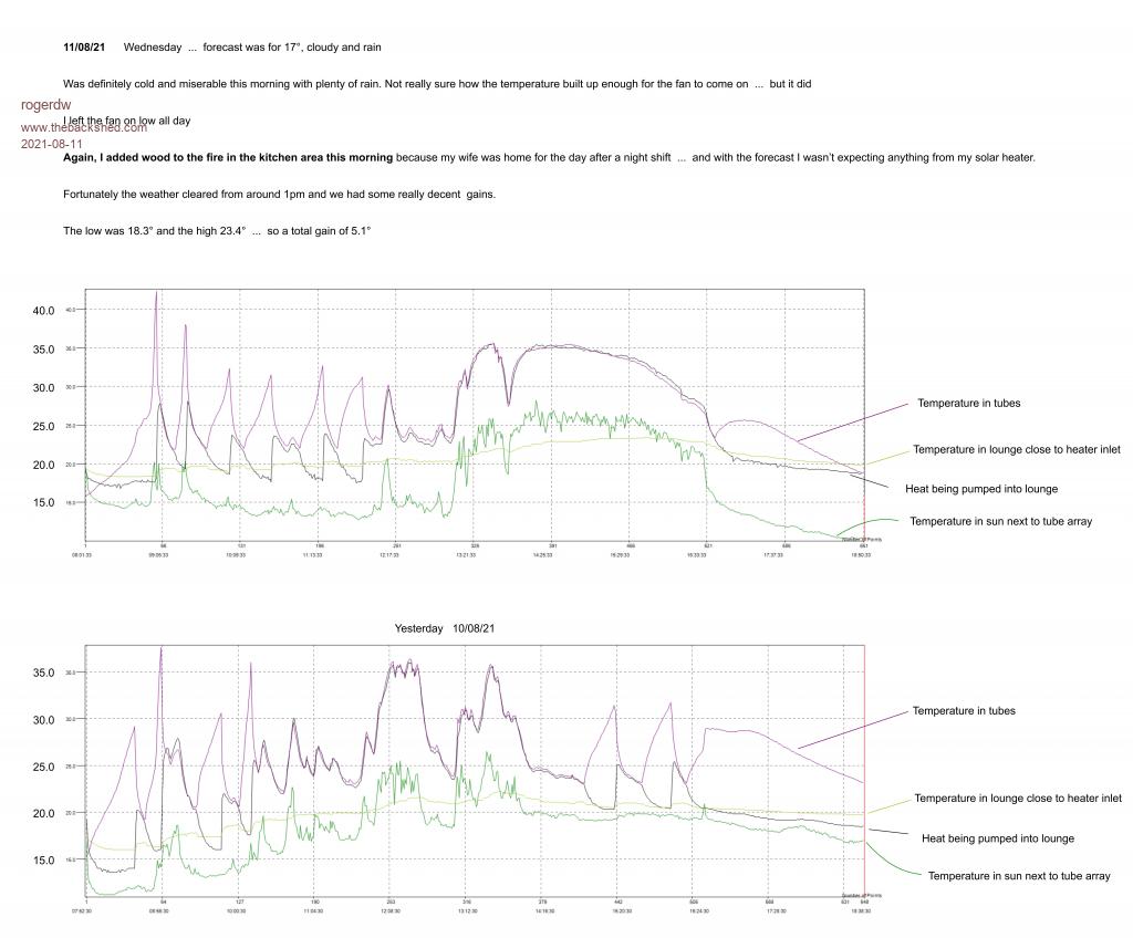

Here are today's results. Started off all drizzly, gray and raining until lunch time and then improved.
I was quite impressed that the output got as high as it did as quickly as it did, once conditions improved.
As mentioned below I did stoke the fire up again this morning at 9am  ...  but did not add any more until this evening

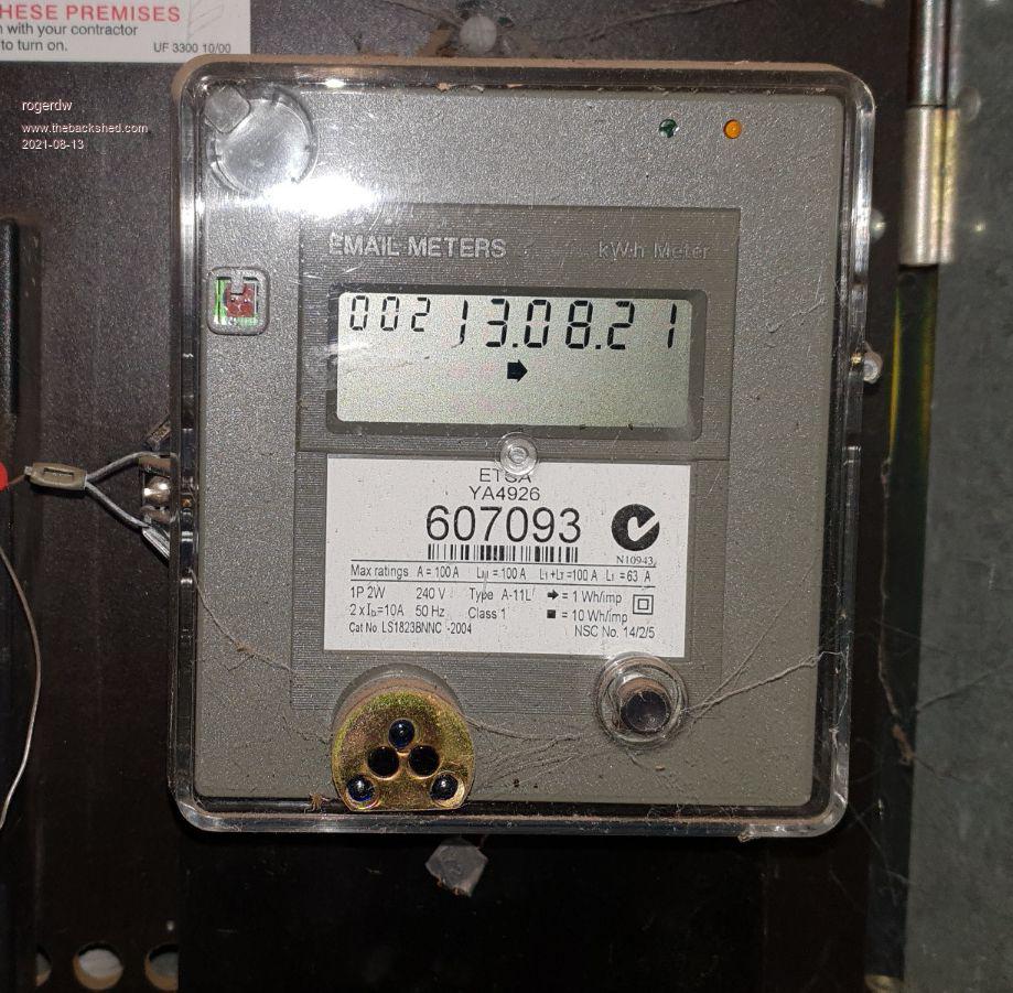

Thought I'd add today and yesterdays results together.
Was happy with yesterdays  ...  but elated with todays.
Cheers,  Roger

I did ask my wife if it was warm enough now  ...  and she hesitated. Seems that some of the stations she's on have the aircon on 24 and others on 26. No wonder it's not warm enough here. It's probably her that sets the temperature at work  ...  but you can see what I'm up against.
Here's a photo of my meter Dave  ...
...  and seeing the ETSA name reminded me I had thought of a name for my heater  ...  an ETSA  ...  Evacuated Tube Solar Amplifier  ...  or ETSAH  ...  Evacuated Tube Solar Air Heater
Just as well I'm not trying to include my name  ...  a WETSA or a WETSAH doesn't quite cut it.
Cheers,  Roger

Couldn't Find much on that meter other than it's an Email/ Ampy/ Landis and Gyr ( they changed their Name then got bought out) model A-11.
By the directional Arrow on the thing I would suggest it's Bi directional... which is good.
Not hard to test them, hook up a GTI and see if the arrow Changes Direction and if the thing counts up or Down.

  Davo99 said  Couldn't Find much on that meter other than it's an Email/ Ampy/ Landis and Gyr ( they changed their Name then got bought out) model A-11.
Least if you got some more panels now you could hook them up in parallel to give your pool pump a boost.
Your suggestion about the arrow made me wonder  ...  if you look on the front, after the arrow it shows 1 Wh/imp  ...  and then a square block with 10 Wh/imp. Any idea what those units are about?
  Quote  Personally, with what I have read about the SA power network, I'd be trying to distance myself from them much as possible.
Yes, they have a bit of a reputation. I don't plan to poke them just to see what happens.

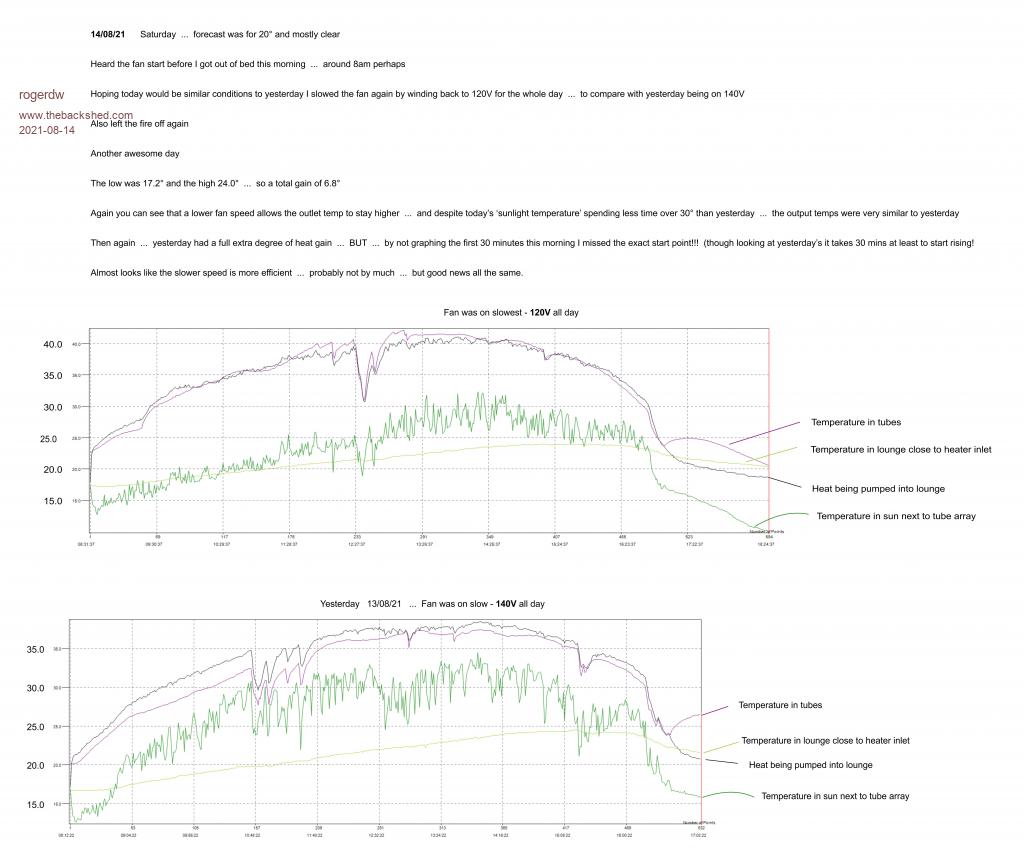

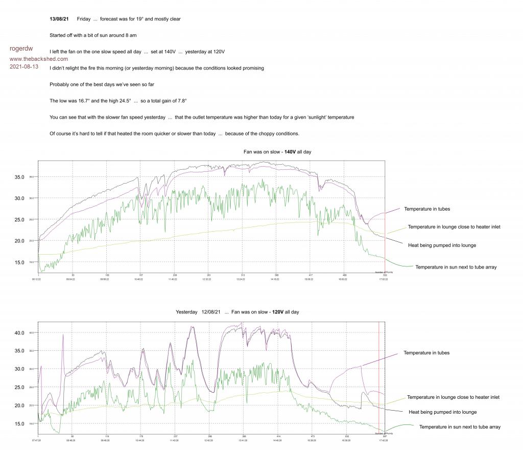

Well time for todays update.
Only thing different today was that I ran the fan slower than yesterday to see what happens  ...  on 120V instead of 140V.
And coz I slept in, I missed the first half hour of activity.
Another beautiful day and very happy with the results again.
Cheers,  Roger

The graphs are a bit difficult for me to clearly define but if the green and very squiggly line is the temp of the logger that is in the sun next to the tubes, why is it so erratic, showing swings of up to 5o if the day was clear?
I'd expect that to look like there was a constant shadowing and then full sunlight all day. Is it just a logger anomaly or something else I have missed?
Oddly, where there was an obvious dip due to a large cloud as I take it, the in sun temp  did not vary nearly as much as the tube and output temps.
The 6.8o temp rise is still significant but how did the higher output temp feel? were you in the house enough to make a judgement on comfort level?
I believe the arrow and the block on the meter indicate unit blocks of measurement now you come to mention it. I surmise that LED at the top right flashes with the power use.
More power the faster it flashes.... to a point.  The arrow is basicly the low range and the square is the high range.
You can count the flashes to determine the approx amount of power being consumed. Obviously of the flashing gets too  fast that's not possible so the meter switched to the high unit count so each flash represents 10x more power  when the block is shown than when the arrow is.
I have a meter in my collection that is probably s slightly newer meter that uses an arrow to show direction. It's quite handy actually for experimenting with IMAGS to see which way the current is flowing although an analogue meter would be better but yet to come across any.
