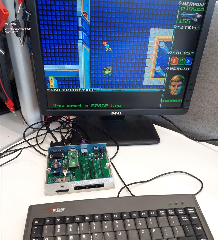

Oh no... Sorry Martin...
Could you please try to re-make your changes. I will stop any work from my side until I see your fixes, and use that as new baseline.
This is probably result of going back and forth with the pet24cMod.bas and pet24eMod.bas around Kevin's changes.
I sincerely appologize.

Posts: 6193
Posted: 09:17am 17 Nov 2023
Hi Martin,
- I will look at the flower pots. Look simple enough (one IF/THEN). But only after you have blessed/adapted the current version. I don't want to go back and forth anymore....only forward...
- About CONTROLLER: I could think about automatic detect of a limitted set of options. Petrs "WII classic" is easy (I2C is present or not). Difference between NES and SNES can be done when pressing a non-NES key on the SNES (you can clock NES with 16 clocks, I have proven that). Detecting parallel keys (Game_Mite) can be done when pressing a key that is not in the PicoGameVGA controller IO. So the controller selection would be text instructions for each controller type so it can be auto detected.
So you may not need a menu. Just "once" text at startup. And save the type for further use.
