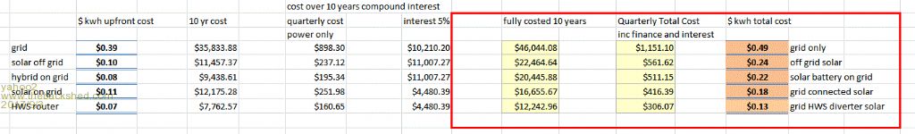

Here are some comparison numbers I done for a refurbishment and upgrade of a solar system to show if it was worth the effort and money.
Upfront costs (the dollars we see going out of our wallet are on the left) and the total cost of ownership is in the red square on the right.
This was a 6.5 kw system with the option of a 10kwh lithium battery bank
The cost of the upgrade to go off-grid with the full kit was a touch over $17,000, you can see when we take the batteries out of the upfront cost there is $6500 less interest (middle column) lost over ten years for the on grid battery-less solar options.
The fact that solar + power diverter rolls the solar only by 25% in this setup is remarkable because the direct solar usage potential in this business is quite a bit higher than most I have seen.
Hotwater, this would be exactly what you are seeing with your diversion system, the automation makes a big difference.
