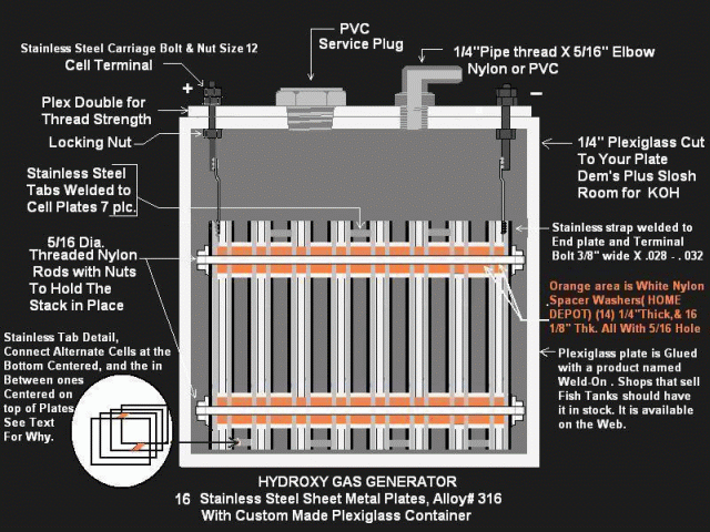

Steven ;
My design for a HYD. generator.
Most Info is on the drawing. If you have any questions post
a note.

very imppressive green belt nice design layout and details. , stainless steel sheets to make a good cell here are very exspensive to get , but the low demands for nickle these days may force it down in price as stainlless steel allso has nickel in it

Greenbelt:
If you design an HOH generator like your drawing, it'll draw so much current,
your battery will explode! Really!
Flash-back Arrestor: Use water. Just bubble your product gas through
water. If you get a back-fire, the water will stop it. If you use steel wool
and there's any oxygen present, you'll get pyrotechnics! Really again!
Honest fellows, I've been there; done that and you do NOT want to treat this
stuff lightly. If your accidental explosion is large enough, all you'll hear for
about half an hour is what sounds like insects on helium! When it goes, it
goes with a loud CRACK and your hearing is toast for a while!
