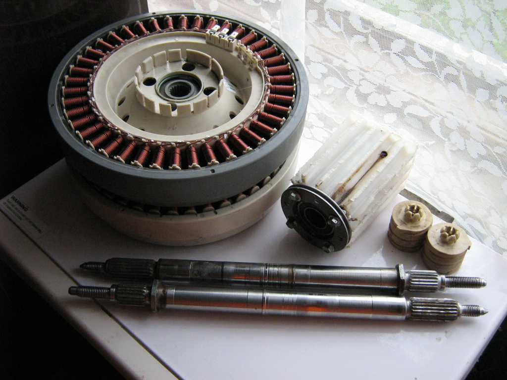

Now, the pictures:
"Ok! Now what?"
Thank you again! Next pictures will be from Windmill project (new topic).

Now take your time, no rush. When I get something unique, like those F&P's, I use them in a way that is not damaging, so I can use them again for another project in the future. So when you build your first windmill, remember to take care of the coils so you can make changes and use the stator again for another windmill at a later date.
Be careful when you separate the stator and hub, get someone to give you a hand, they are difficult to get apart and you can pinch a finger in there.
Another tip, store the magnet hub flat side down, never sitting on its side. I had a hub that was sitting on its side on a shelf for a couple of months. It was warped after that, out of round, and would scuff the stator when put together.

This is how I remove the stator from rotor.
1: Place the end of a shaft through the stator and partly into the rotor hub.
2: Wrap a towel or big cloth around hands.
3: Hold the end of the shaft on a bench top, protect the bench with a piece of wood. The shaft is verticle and the rotor with stator is at the top.
4: Bang end of shaft against the wood, a couple of gentle blows first then increase force until the stator falls out of the rotor and lands on your hands.
Note, just hard enough as you do not want to damage the rotor hub. Do not push the shaft right into the hub so always leaving room to absorb excess force.
Other method, not easy but quicker.
1. Have some padding on the floor.
2. Bend over. Hold rotor with stator side downwards. Hold rotor with finger tips gripping bottom edge.
3. Move rotor with stator quickly towards floor, suddenly stop when about 750mm from floor.
4. If you are strong the stator will drop out onto the floor!
Hope this is useful information!

Posted: 10:58pm 15 Jul 2007
Hi John, I have a question:
When you packed the motors you put this rotor
with 100 type stator and this rotor
with 80 type stator. You had a reason doing this? This is the way? I mean, this is how I must do it?

Hi Vasi
I did nothing special in putting the pieces together. Those were two rotors and two stators I had so I just put them together to go in the box.
One rotor may be better than the other but I do not know.
