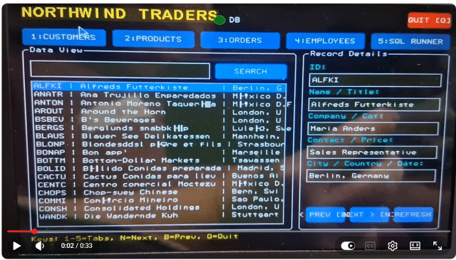

Meanwhile, it's hard to keep up, but I'm trying to be a fast follower. Gemini  Antigravity CLI 1.1.5 with a Pro monthly subscription running in Windows PowerShell built this in about an hour, talking directly to the PicoCom3 over Com4.
Youtube Northwinds

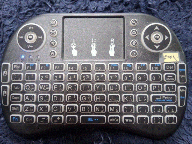

I plugged in the usb RF module from this to get mouse and keyboard:

   USB mouse: high-resolution mice fixed, and any HID mouse now works — mice reporting 12- or 16-bit movement moved erratically: the firmware left the mouse in USB boot mode (plain 8-bit reports) while decoding the full-resolution format the mouse describes, so the two never matched. The mouse is now switched to report mode at connect (as MMBasic does), and the decoder has been generalised to read each mouse's own HID descriptor — any button count, movement resolution, wheel position or report-ID scheme — instead of recognising three fixed layouts. Combo receivers that share the mouse interface with media keys no longer jitter the cursor when those keys are pressed, and a mouse that refuses the mode switch falls back cleanly to 8-bit decoding.
