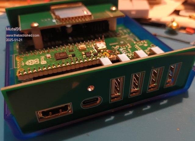

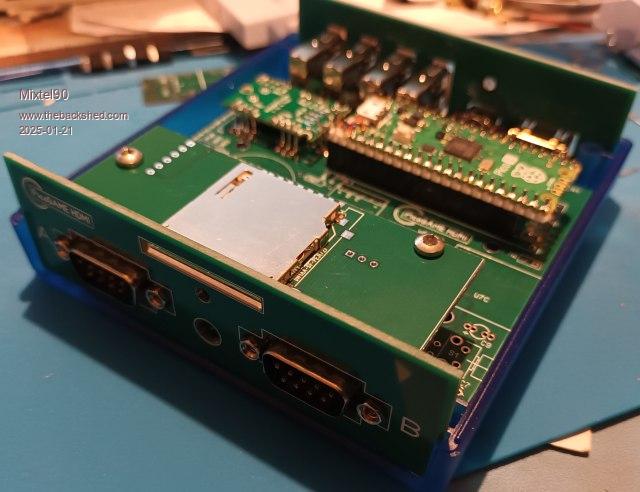

Things are progressing. I got the saw out today and this is the result of a "dry run". Only the HDMI socket, SMD resistors, USB-TTL module and USB hub are soldered in - I'm waiting for bits.
The front panel seems to be *just* a touch too high, but that might be my admittedly inaccurate sawing. It's nothing that a touch with a file won't fix. Even the skinny board for the Reset button on the back seems to fit properly, although the hole may need to be filed just a touch. I can't be certain as I've only fixed the board at one end (over the USB sockets).

The USB problem was a couple of dodgy solder joints. I've decided that I don't like that method of of mounting the USB hub very much, it'll probably plug into 2mm headers next time. I've had the full complement of keyboard, mouse and two generic controllers on it.

I'm not impressed by the rear Reset button as it doesn't quite line up with the hole in the rear panel. Still, it was just squeezed into the gap left on the 100x100 PCB and it should have been deeper really.

The daughter board with the full size SD card socket and LED is something else that I like. *There is a PCB error!* The SD card socket GND pins are floating. Easily fixed with a link from pin 6 to the GND pin towards the rear of the daughter board. This will be fixed at the next release.
The fact that everything fits into the case is a bonus. :)
