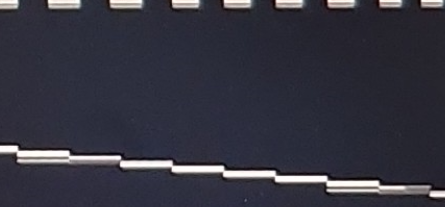

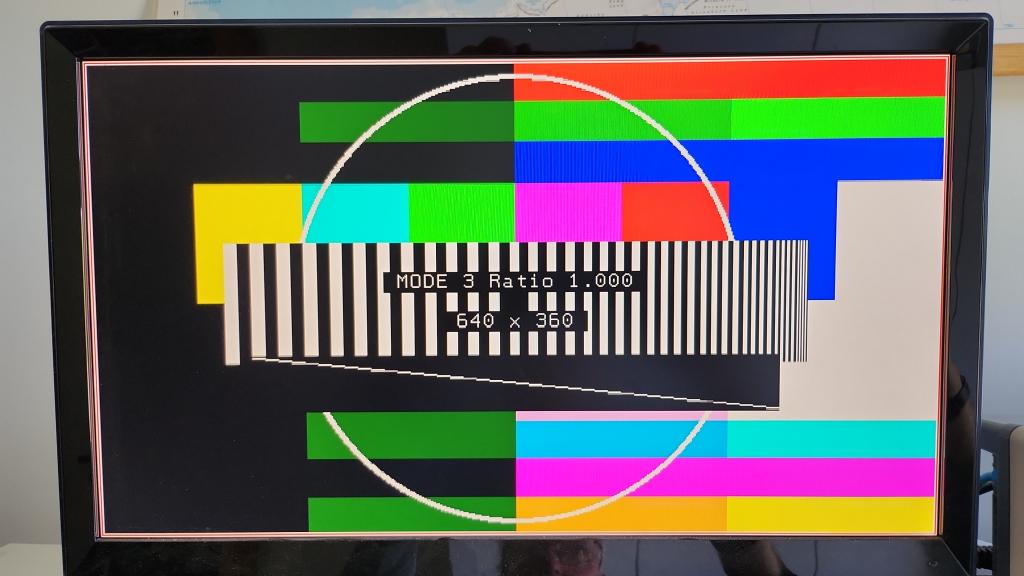

PicoMiteHDMI MMBasic Version 6.00.00RC2
With the tweo wide resolutions 1024 and 1280,
MODE 2 and 5 are very stable.
MODE 1 and 3 have what looks like interlacing gone astray.
In mode 3 there are 4 good lines then 2 lines which appear to be  alternating between correct and out of order.
Tested on 2 monitors, both native resolution 1920 x 1080
All modes are good in 640 resolution.
RC1 was good in all resolutions.

V6.00.00RC3 for HDMI and HDMIUSB
PicoMiteHDMIRP2350V6.00.00RC3.zip
Should fix various issues in RC2
1024x600 is not a standard resolution that monitors and/or TVs can handle. I just implemented 1024x768 as a higher resolution for those using standard 4:3 monitors
