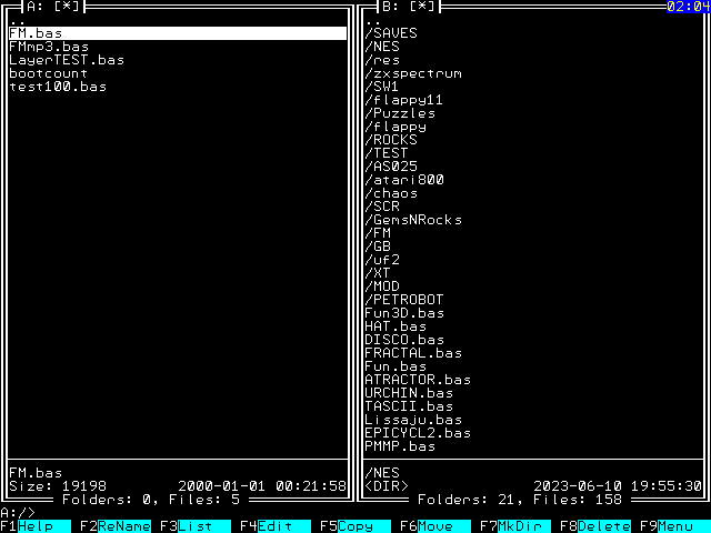

Unfortunately, this FileManager was not initially made flexible for different resolutions, but was adjusted to the MODE 1 resolution 640x480 and font 8x12.
I already see that it needs to be redesigned at least to work through the terminal.

My respects Peter!
Thanks to the new command
EDIT FILE fname$
released in the new PicoMite V6.00.00RC4, my File Manager can now open and create small files for editing.
javavi_FM_v14.zip
Edited 2024-10-05 18:22 by javavi

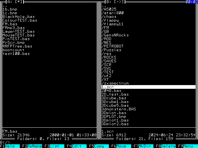

jFM v.1.7 for PicoMiteVGA/HDMI
jFM_v1.7.zip

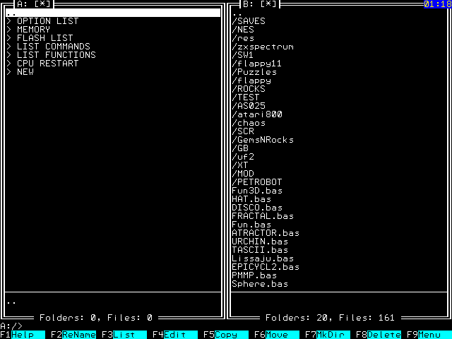

- added MENU by F9 from which you can execute the necessary commands or run programs
> command
* program
- scrolling the list of files forward and backward with arrows or PgUp PgDn
To launch FM by pressing the F9 button (you can F5...F9)
you need to save the program in the memory slot and set it to launch by pressing the Fn button

jFM v.1.8 for PicoMiteVGA/HDMI
jFM_v1.8.zip
- RAM consumption optimization
- plays mp3 files on Pico2
- displays information about the current file at the bottom of the panel (size&date)
- saves the Screenshot image by pressing the PrintScreen button
Edited 2024-10-13 21:32 by javavi

FM v.1.9 for PicoMiteVGA/HDMI
jFM v1.9.zip
File Manager updates:
- Added navigation with buttons [Home], [End]
- Added sorting of file list [Alt+F3], [Alt+F4]
- Well, and some DTMF sound :))
What are your thoughts, write here!

First off, I love your program.  It gives me what I miss from my CMM2s.
There is an issue with this version.  If you Hit F9 and then select commands list it lists them but then REBOOTS!!!  every time.
I am on RC15 on a PICOHDMIUSB board.
