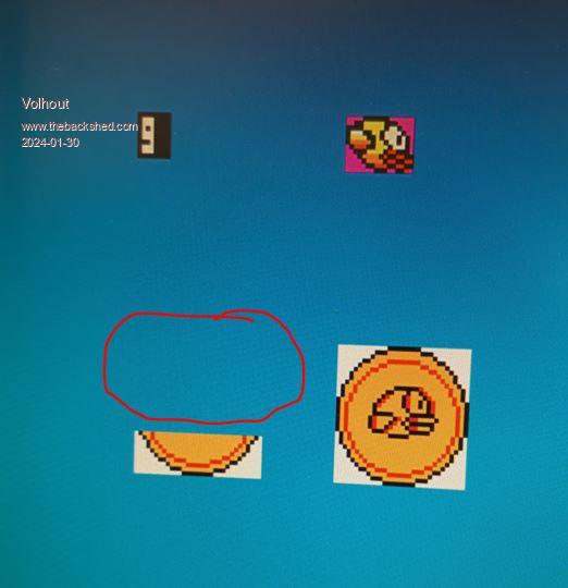

Peter, Geoff,
I would like to report a bug in the PicoMiteVGA firmware V5.08.00.
It is about the SPRITE LOAD command. There are 2 issues
1/ SPRITE LOAD only works when you increment the sprite number with 1 each successive load. You can not load sprites 1,2,7,8 without loading 3,4,5,6 in between. (you do not get an error, but when showing/writing sprites 1,2,7,8 you get black squares for 7 and 8. This is an inconvenience, and may not be worth fixing.
2/ SPRITE LOAD seems to inherit the vertical size from the sprite loaded before. See attached test program. It load the same sprite as #3 and #4, and shows them both.
You can clearly see that #3 has the vertical size of (previously) loaded #2. This is an annoying bug.
sprite_fail.zip
Posts: 6192
Posted: 08:01am 30 Jan 2024
The bug is even clearer to see with this version.
sprite_fail.zip
Note that in the missing area of sprite #3, sometimes parts of other sprites show. Not in this simple program. So it may be a pointer pointing to the wrong address.
Note also that sprite #2 (16x12) is not cropped to the vertical size of sprite #1 8x10). So it does not happen for all sprites.

Posts: 12045
Posted: 12:20pm 30 Jan 2024
  Quote  The bug is even clearer to see with this version.
What am I supposed to be seeing?
Posts: 6192
Posted: 12:51pm 30 Jan 2024
Huh....
I tried this on 2 different platforms (your VGA rev.1.7 and PicoGameVGA 1.4) and both show the problem.
The only thing I can think of that may be different, is that there is daya in FLASH slot 3 and slot 2. I erased all data from flash slot 3 and 2, and the problem still shows.

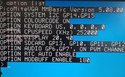

Posts: 12045
Posted: 12:58pm 30 Jan 2024
Your option keyboard looks very strange - try OPTION KEYBOARD DISABLE and then OPTION KEYBOARD US
Try re-flashing with this - will erase all the options, a: drive etc.
IMPORTANT: then apply the options manually, don't use disk load just in case

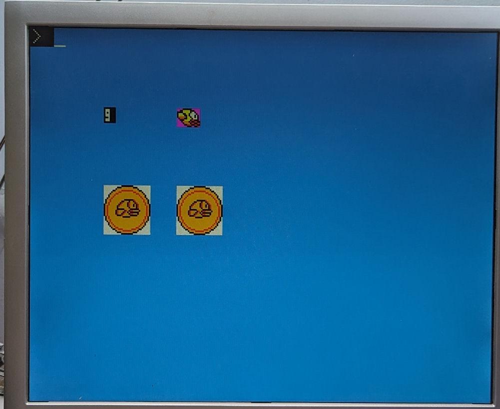

Posts: 6192
Posted: 01:23pm 30 Jan 2024
Hi Peter,
EDIT: MY PS2 KEYBOARD DOES NOT WORK WITH THIS VERSION (ONLY USB Teraterm).
But it fixed the sprite issue
I cleared the flash, reloaded the version on Geoff's website, manually added all options, and the problem is also gone. I have no idea what this was, but on multiple systems.

Posts: 6192
Posted: 07:03pm 30 Jan 2024
Hi Peter,
Small update...
My second unit at home is not fixed. I tried
- Nuke flash + your above suggested PicoMiteVGA(3).zip, no options added(*): problem remains.
- Nuke flash + Geoff's V50800, no options added: problem remains
- Add options, one by one : problem remains.
Sorry to say, but this is not fixed.
I will do some more experimenting..
(*) No options means run from A:
HOERAH, FOUND IT
When I copied the files on B: using the PC, it worked correct.
When I copy the files to A: using MMCC (XMODEM) it does not work, I get half sprite
When I copy the files from B: to A: using COPY "*.*" to "A:" it works correct.
Apparently XMODEM corrupts the sprite files (appends ?) and that causes the problem.
Thank you for your attention. Maybe this experience should be common knowledge.
Edited 2024-01-31 05:17 by Volhout
Posts: 6626
Posted: 08:19pm 30 Jan 2024
  Volhout said
HOERAH, FOUND IT
XMODEM will pad the file size up to a 128 byte boundary with either chr$(0) or chr$(26).
Most files have handled the surplus characters but it appears that sprites are a bit fussy.
I don't have a picoVGA to test with.
It is relatively easy to trim the extra characters off but it would be best if the sprite load command did this as part of the loading.
