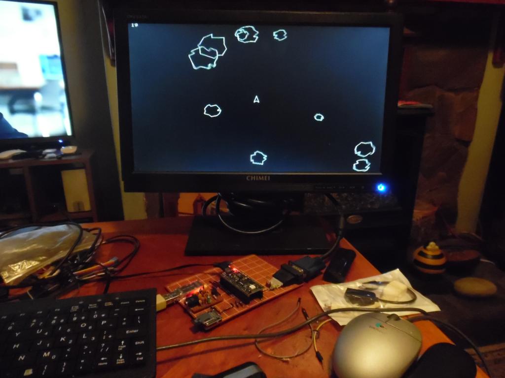

Posts: 6187
Posted: 08:51pm 23 Jul 2024
Based on Vegipete's teaser.
Do not comment on coding, this is experimental stage. Cleanup of code will be when I know how I am going to implement things.
Fly with cursor keys (UP, LEFT, RIGHT)
Fire with <SPACE>

I had to reflash vga usb and mmedit as no mmcc ?
if I don't use mmbasic for a few weeks I forget how it works

I got stationary rocks. is it
  rock(i,4) = 1-rnd*2   ' x velocity
  rock(i,5) = 1-rnd*2   ' y velocity
I had to comment the sound as unknown command.

  stanleyella said  I got stationary rocks. is it
You should set OPTION SOUND

So I may create a font that mimicks the vectors.
A Font like this?

Wauw ! That is fast.... 64 characters is fine.
However.. there is a drawback to your font. It is 8x8 pixels. To match it in the game it should be 16 or 20 pixels high.
But when you use the scale in the TEXT command, it also double the line width, making it very different from the "vector" style in the game.
See these screenshots (not very clear, but they did for me). I guess the font should be something like 20x12 or 16x10. Note also the somewhat strange "G".
