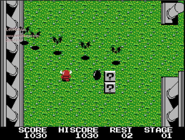

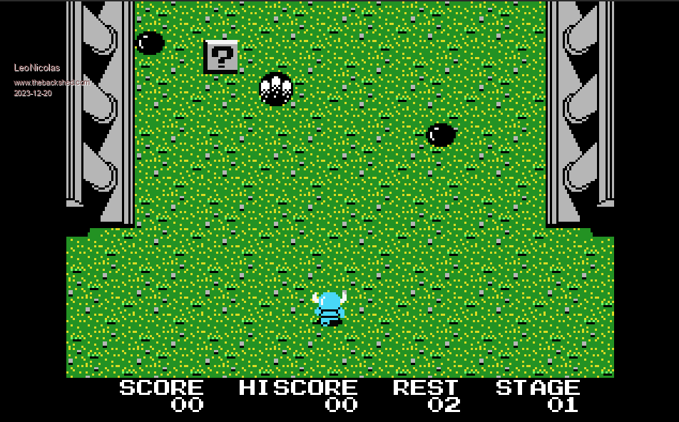

Weapon chrystals in development
Soon, Popolon will have new and more powerful weapons to fight against the enemies.

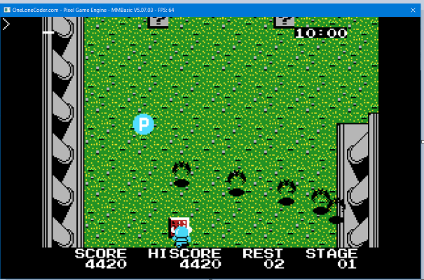

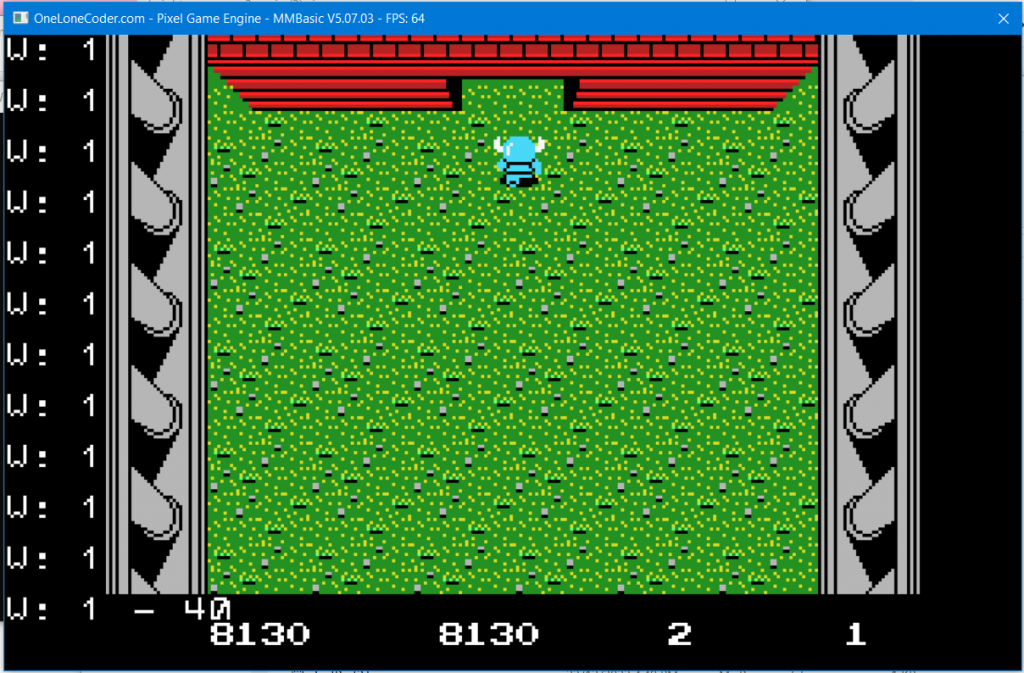

Did I say a was a geriatric? Not sure that I did try the latest version of the game now but I just did on the latest MMB4W and saw some funnies on the left of the screen if that helps.
I can go no further up than here.
EDIT: This is DEFINATELY the latest of each:
It's difficult to know which version is which. Maybe I shouldn't keep the old ones.
The "funnies" are not there now but the game just crashed as you can see.
No error reported.
Edited 2023-12-27 11:30 by Turbo46
LeoNicolas
Joined: 07/10/2020
Posts: 625
Posted: 03:02am 27 Dec 2023
Thank you for testing the game.
That weird text on the left side of the screen was my fault. I committed a debug print. I will remove it in the next version.
There is no boss implementation yet, so the stage ends on that portal.
I don't know how to check why the game crashed without any error. I will try to find something in the MMBasic manual.
