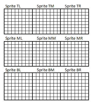

I now managed to decode the structur of the original Tileset Files,
Every Tile is 3 by 3 Chars, as they where original PETSCII encoded.
they are serially encoded
256 Bytes TL starts at Byte 514 of the Tileset File
After this next 256 Bytes belongs to TM ....and so on
so you end with an Array of 9x256 Bytes
I am still working on creating 8x8 Pixel Tiles that match to the Tileset.
All in all this will use much less memory than 256 24x24 Tiles
Edited 2023-09-21 17:51 by Martin H.

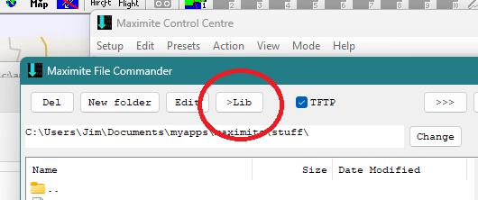

Posts: 4405
Posted: 09:52am 21 Sep 2023
  TassyJim said  Loading up the library is not difficult...
Yes Jim, but you've got a PC in the driving seat and are sending a command to the serial console / prompt.
The use-case that I believe @Volhout wishes to address is:
- Start standalone PicoMiteVGA
- Type one command on the PS2 keyboard that will run "PETSCII Robots" including replacing the current contents of the LIBRARY with contents read from one or more files.
Now other than potentially setting up a macro on one of the Fn keys (and that won't help you if you wanted to start PETSCII Robots from a separate menu program) there is as far as I can see currently no way to achieve this.
Edited 2023-09-21 19:54 by thwill
