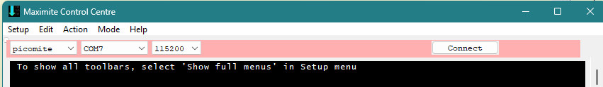

V5.2.6 is now on the website
I fixed a few bugs including adding some sanity checks to better handle multiple monitors.
MMCC will start up in 'Lite' mode next time you start it.
Lite mode hides most of the options that seen to confuse the beginner.
Don't panic, select Show full menus in Setup and things go back to normal.
If you have any 'favorites' set, the Presets menu will be shown in Lite mode.

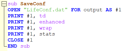

Hi Jim,
MMEdit seems to have a blind spot for SUB. I'm using the latest version. Working on MMB4W:
The tkn file does contain "sub" and if I change the syntax to CMM2 or some other the result is the same SUB is not recognised.
MMEdit knows internally that it is a sub as you can see by the collapsible thingy but the syntax is not highlighted and capitalized.
