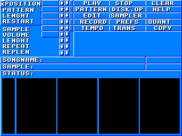

for someone who dares to write a traker for the Pico. Here is my suggestion for the GUI (inspired by the ATARI NOISETRAKER)
this does nothing, just draws the GUI and waits for ESC to be pressed.
Dim integer COL(15):Restore colors:For f%=1 To 15:Read COL(f%):Next f%
MODE 2:Font 9:CLS COL(11)
DTEXT 0,3,"xPOSITION":DTEXT  4,14,"PATTERN":DTEXT 4,24,"LENGHT"
DTEXT 4,34,"RESTART":DTEXT 4,48,"SAMPLE":DTEXT 4,58,"VOLUME"
DTEXT 4,68,"LENGHT":DTEXT 4,78,"REPEAT":DTEXT 4,88,"REPLEN"
DTEXT 4,102,"SONGNAME:":DTEXT 4,114,"SAMPLE:":DTEXT 4,126,"STATUS:"
Frame 0,0,72,44:Frame 0,124,320,116
DTEXT 146,2,"PLAY   STOP    CLEAR":DTEXT 132,13,"PATTERN DISK.OP  HELP"
DTEXT 146,24,"EDIT  SAMPLER":DTEXT 140,35,"RECORD  PREFS  QUANT"
DTEXT 142,46,"TEMPO  TRANS    COPY"
For f%=0 To 88 Step 11
If f%<66 Then Frame 73,f%,30,10
Frame 104,f%,8,10:Frame 113,f%,8,10:DTEXT 106,f%+1,"}":DTEXT 115,f%+1,"{"
If f%<55 Then
 Frame 122,f%,6,10 :Frame 129,f%,63,10:Frame 192,f%,64,10:Frame 256,f%,64,10
EndIf
Next f%
Frame 0,100,255,11:Frame 256,100,64,11:Frame 0,112,255,11:Frame 256,112,64,11
Frame 129,55,198,44:frame 0,1,8,12
Box 4,138,22,98,,0,0:Box 29,138,70,98,,0,0:Box 101,138,70,98,,0,0
Box 174,138,70,98,,0,0:Box 246,138,70,98,,0,0
do:n$=inkey$:loop until n$=chr$(27)
Sub Frame xx,yy,ww,hh
  Line xx+1,yy,xx+ww-1,yy,,COL(7):Line xx,yy+1,xx,yy+hh-1,,COL(7)
  Line xx+1,yy+hh,xx+ww-1,yy+hh,,COL(1): Line xx+ww,yy,xx+ww,yy+hh-1,,COL(1)
End Sub
Sub DTEXT xx,yy,TE$
 Colour 0:Print @(xx+1,yy+1,1)TE$:Colour col(7):Print @(xx,yy,1)TE$
End Sub
colors:
'--PicoMite Colorscheme accordung to matherp
Data RGB(BLUE),RGB(GREEN),RGB(CYAN),RGB(RED)
Data RGB(MAGENTA),RGB(YELLOW),RGB(WHITE),RGB(MYRTLE)
Data RGB(COBALT) ,RGB(MIDGREEN),RGB(CERULEAN),RGB(RUST)
Data RGB(FUCHSIA),RGB(BROWN),RGB(LILAC)
' 8x8 Font (Martin H.)
' Font type    : Full (95 ChArACtErs)
' Font size    : 8x8 pixels
' Memory usage : 764 Bytes
DefineFont #9
 5F200808
00000000 00000000 18181818 00180018 006C6C6C 00000000 367F3636 0036367F
3E683F0C 00187E0B 180C6660 00066630 386C6C38 003B666D 0030180C 00000000
3030180C 000C1830 0C0C1830 0030180C 3C7E1800 0000187E 7E181800 00001818
00000000 30181800 7E000000 00000000 00000000 00181800 180C0600 00006030
7E6E663C 003C6676 18183818 007E1818 0C06663C 007E3018 1C06663C 003C6606
6C3C1C0C 000C0C7E 067C607E 003C6606 7C60301C 003C6666 180C067E 00303030
3C66663C 003C6666 3E66663C 00380C06 18180000 00181800 18180000 30181800
6030180C 000C1830 007E0000 0000007E 060C1830 0030180C 180C663C 00180018
6A6E663C 003C606E 7E66663C 00666666 7C66667C 007C6666 6060663C 003C6660
66666C78 00786C66 7C60607E 007E6060 7C60607E 00606060 6E60663C 003C6666
7E666666 00666666 1818187E 007E1818 0C0C0C3E 00386C0C 70786C66 00666C78
60606060 007E6060 6B7F7763 0063636B 7E766666 0066666E 6666663C 003C6666
7C66667C 00606060 6666663C 00366C6A 7C66667C 0066666C 3C60663C 003C6606
1818187E 00181818 66666666 003C6666 66666666 00183C66 6B6B6363 0063777F
183C6666 0066663C 3C666666 00181818 180C067E 007E6030 6060607C 007C6060
18306000 0000060C 0606063E 003E0606 42663C18 00000000 00000000 FF000000
7C30361C 007E3030 063C0000 003E663E 667C6060 007C6666 663C0000 003C6660
663E0606 003E6666 663C0000 003C607E 7C30301C 00303030 663E0000 3C063E66
667C6060 00666666 18380018 003C1818 18380018 70181818 6C666060 00666C78
18181838 003C1818 7F360000 00636B6B 667C0000 00666666 663C0000 003C6666
667C0000 60607C66 663E0000 07063E66 766C0000 00606060 603E0000 007C063C
307C3030 001C3030 66660000 003E6666 66660000 00183C66 6B630000 00367F6B
3C660000 00663C18 66660000 3C063E66 0C7E0000 007E3018 70707000 002070F8
00181818 00181818 F8702000 00707070 00466B31 00000000 FFFFFFFF FFFFFFFF
End DefineFont
