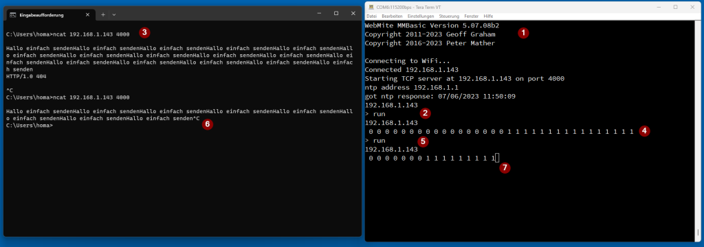

My TEST code:
Dim buff%(4096/8)
Print MM.Info(ip address)
LongString APPEND buff%(), "Hallo einfach senden"
senden=0
WEB tcp interrupt webinterrupt
Print senden;
 If senden=1 Then
   WEB TCP send 1, buff%()
 EndIf
Pause 1000
Loop
Sub webinterrupt
  senden=1
End Sub
1) Start the WebMite
2) Running the programme
3) Client establishes connection (test with ncat instead of home-assistant.io) - ENTER necessary before WebMite starts sending!
4) Exit WebMite (Ctrl-C) ==> no problem Connection ends cleanly, see message in CMD window
5) 2nd test, restart the test programme - ENTER necessary before WebMite starts sending!
6) This time the connection is terminated by the CLIENT (ncat).
7) WebMite crashes, it does not notice the termination. Or what am I doing wrong here?
So the two points are, how do I get the status that a connection exists and how do I know that I am no longer allowed to send.
Matthias
