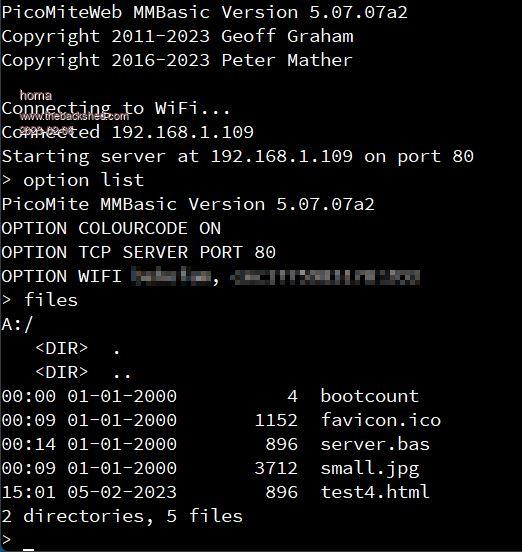

Copy the 4 files from the ZIP file with:
> xmodem receive "filename"
and then into TeraTerm file Xmodem SEND the matching file.
In the screenshot still the OPTION List.

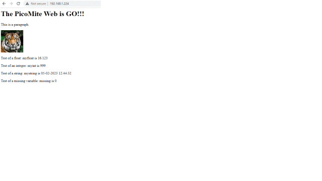

Ok, this is now being served by the PicoMiteWeb:
A long way to go before it's functional, since I don't know how to interact with it. But very good progress.
I've subsequently seen how to get the date right with "WEB ntp -5", but in my formatting, I don't have the time right or the day of the week.

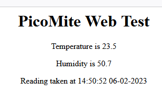

With a slight modification to Peters code, a simple weather station is born.
Page refreshes ever 15 seconds and the DHT22 is read every 3 seconds to allow for any bad readings.

Result:
The system is undergoing a soak test.
