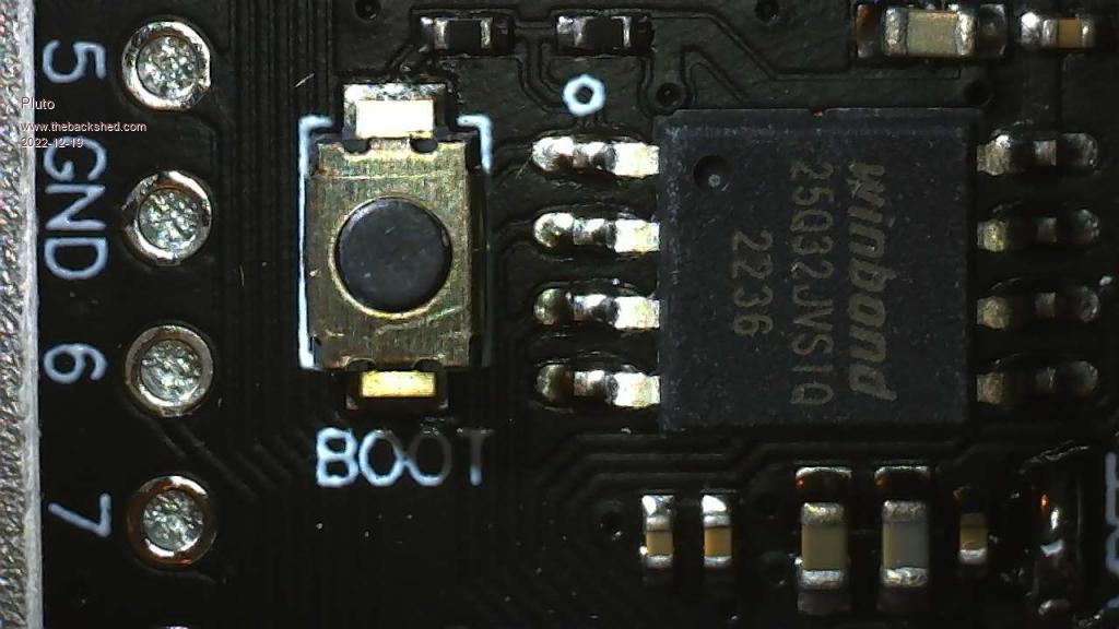

Winbond 25Q128 no logo on the RP chip, just RP2-82. Cheap enough to have a punt.
Appears to have linear 3V3 reg.
Edited 2022-12-19 07:22 by phil99

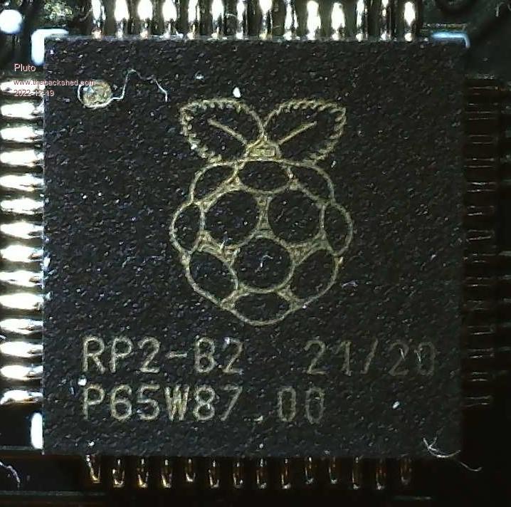

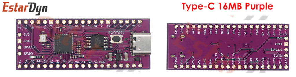

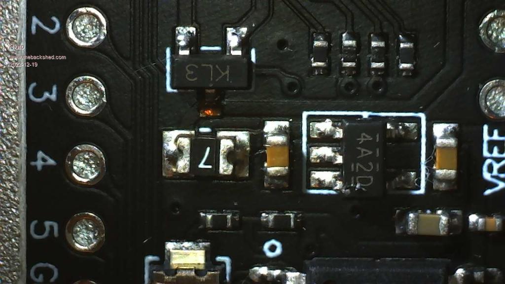

The ones I bought and successfully use do also look like there would be no Logo on the RP2040 chip on the seller's site. The arrived modules do however have the Raspberry Logos.
https://www.thebackshed.com/forum/ViewTopic.php?TID=15398&P=2#195152
Flash memory:
I suppose one of these is the regulator:
Latest order was 3.30EUR incl shipment and VAT (4MB version). Still to come 16MB version at 3.63EUR incl shipment and VAT.
Up to now all of the 4MB modules have functioned as expected for PicoMite.

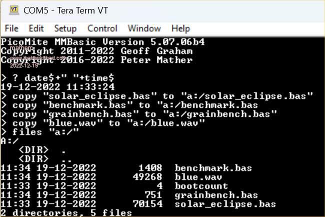

I've found a way of using the flexible attributes capability of LittleFS to implement time stamping of files so the flash system is now pretty much indistinguishable from the SD system
Please test this version. My current feeling is to skip the 5.07.05 release and go straight to this. The changes are all in the file system so as long as that works OK there should be little else that may have gone wrong. Please report any issues.
I've kept the active file system as the SDcard if enabled (and a disk in place) so that existing programs run without change.

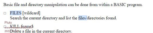

FILES
FILES "A:"
FILES "A:/"
Are these not supposed to be in a program?
It results in: "Error : Invalid in a program"
Posts: 12058
Posted: 01:32pm 19 Dec 2022
  Quote  Are these not supposed to be in a program?
No: they clear the variable memory for buffer space to do the sorts so not possible
Pluto
Joined: 09/06/2017
Location: Finland
Posts: 418
Posted: 01:44pm 19 Dec 2022
Thanks Peter!
Could maybe be mentioned in the manual.
Page 38 in the PicoMite User Manual says:
