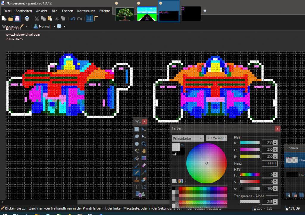

Hi vegipete
i ve done some little changes in your code and added the new Protagonist.

compressing the Sprite Data
--- Mart!ns little Toolbox
So far I've used a text editor to search and replace repeating parts of the Sprite Data strings with the compressed form.
which is quite laborious.

You can do something like this 2-3 times, but it's boring and a real punishment. So I thought, the pico can do that much faster and with less effort so let him do the work

in combination with the sprite read and expand routine you can save quite a few kilobytes.
happy pixel counting
Mart!n
