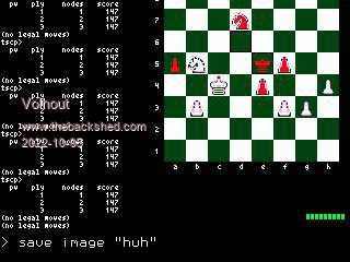

A simple stack usage bar graph... requires RC5 or later
'changes to monitor STACK usage (require picomite 5.07.05RC5 or newer)
settick 200,showstack
dim bar$=space$(8)
dim i:for i=1 to 9:bar$=bar$+chr$(127):next 'font 8, chr$(219) in other fonts
sub showstack
 local a%,b%
 a%=mm.info(stack)
 a%=a%-&h2003f800  'stack info from matherp
 a%=a%/1000 'value 9...2'
 if a% < 4 then
   b%=rgb(red)
 else
   b%=rgb(greeN)
 end if
 text 280,220,mid$(bar$,a%,9),,,,b%
end sub
'end of stack monitor changes ----------------------------------------
Edited 2022-10-04 18:59 by Volhout
Posts: 12035
Posted: 09:05am 04 Oct 2022
But remember the stack usage subroutine uses stack
Best is to capture the stack level in a variable and then output it in the main program where stack usage is at its lowest
Edited 2022-10-04 19:07 by matherp
Posts: 6185
Posted: 10:05am 04 Oct 2022
  matherp said  But remember the stack usage subroutine uses stack
May be unavoidable with my skill set. If you place monitor code at fixed locations in the main code, you need know where. The settick interrupts at (for the main program) random moments. Agreed, the settick interrupt is an layer extra, using stack.
If I knew exactly at what line of the code stack usage was most, I would place the monitor there... But it is too complex without a tracing tool. Candidates would be "in-check" and "eval_". Mostly "eval_", but it calls lots of other "eval_..." functions.
So best would be to place a monitor in all of those.
I will look at that tonight...

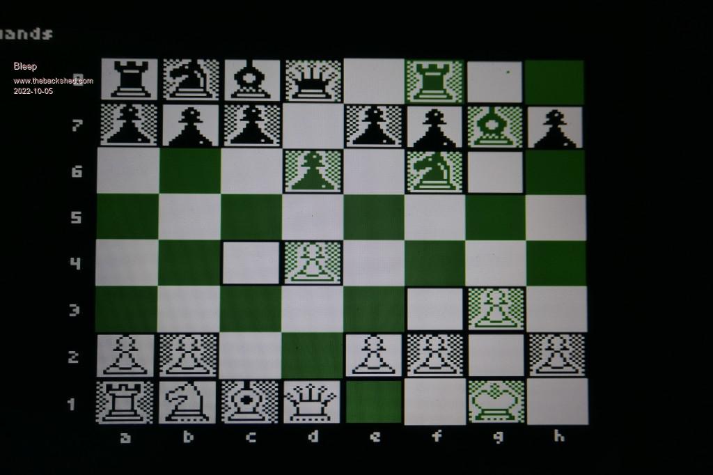

Hi Martin,
If you can get them into the same arrangement as this bmp file, it is 240*40 the image info says it's 1 byte per sample with 3 channels, which means I assume 24 bits per pixel, we could look at incorporating them, you can use the standard range of PicoMiteVGA colours if you like, the black and white shaded background could be a problem, because of lining up the shading when they are put on the board, but if you put an extra empty 'black' & 'white' square on the end we can give it a go, so eventually 260*40, if you stay with 'black' & 'White', or 240*40 if colour.
SmallPieces.bmp.zip
Regards Kevin.

Hi Martin,
I've just had a look at the manual, it says MMBasic can handle black and white bmp files, so presumably 1 bit per pixel.
As an experiment if you can produce a 520*80 version of the bmp in black and white, ie all the pieces as above, plus an empty black and white square, we can try using mode 1, higher resolution screen. I have no idea if the board and text can be made to fit, but it'll potentially be worth a try.
Regards Kevin.

Hi Martin,
I also need the two empty squares, one black one white, either on the front or back of that bmp, so that it is 260*40. or even 520*80 if we try for the higher resolution.
Thanks.
Bleep
Joined: 09/01/2022
Posts: 863
Posted: 04:12pm 04 Oct 2022
First attempt, not sure why the green colour is showing on the pieces, I thought they should be just black and white?

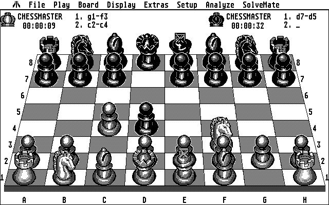

the Supreme discipline would be a 3D(like) view  but for this I have to draw all Figures as Sprites .. that will Take some time.
It would also have to user Framebuffer and Layer ...
(just for Inspiration)
Something like Chessmaster on the old Atari ST:
