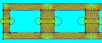

Peter, I have done a number of simulations along the
same lines and and even delved into the LUA scripting to
automate a large portion of the simulation of axial
alts. One point of interest I have found is in comparing
dual magnet rotors to single magnet rotors (with a blank
disc for return path) is that the average flux in the
gap for the single magnet rotor is significantly more
than the half you might expect compared to the dual. In
fact it is much closer to 2/3 for the typical 2x1x1/2"
magnets on 1/2" thick disc with a 1/2" gap. This would
imply that you could achieve 2/3 the output with 1/2 the
magnets. Given that the magnets are typically the most
expensive componenet for your average DIY'er it may be a
more cost effective solution in some cases. Some futher
rough calcs indicate that a single (magnet) rotor using
16 magnets rather than the typical 24 magnet in a dual
magnet rotor should give a 20% increased output. Of
course this would require more metal (1/3 larger
diameter discs) and 1/3 more copper (4 coils per phase
instead of 3). With out calculating some actual
quantities and values, I'm not sure where the break even
point would be but I found it interesting anyway

Hi jiomovonz,
I am building a new dual rotor AxFx alternator. It is interesting that the FEMM simulation gives a 16% increase in avereage flux. This may be a result of the complex field from the rectangular bar magnets. I am using 2"x1/2" round disks. I have almost finished my coil test rig. I will initially be using only one magnet ring, and a blank iron plate return path. I was planninng on doubling the emf to guage the dual magnet ring oputput. It seems that I may actually need to test with the dual magnet rings.
Re the costings for magnets. To go to the bother of making an alternator and not using 2 magnet rings is not really plausible. My magnets mentioned above cost me AU$12 each. The $144 for a second magnet ring is money well spent, as This efectively doubles the alternator max power. This will translate in my case to a higher alternator efficiency. When I sell power for 64c/kWhr, the small additional magnet cost will not take long to be paid off.
Gordon.

Jim,
In the past I have simulated exactly the same as you ( http://picasaweb.google.com/lh/photo/7NDojUFBLhKs9APJhLiKPQ? feat=directlink. In my experience magnetic flux drops to 75%, so voltage will drop to 75% too (ceteris paribus). This means power output will drop to about 56%, nearly half. Half the magnets yields about half the power. No gain to be had here from going to magnets on only one rotor disc.
I wholeheartedly agree with Gordon; magnets and copper wire are the heart of any generator. Skimping on either is not smart. I highly value my time and effort and wouldn't want to waste it on projects that will end up mediocre. I always try to do a perfect job, or at least to come as near as possible as I can. Mediocrity is not an option.
BTW, it's nice to see you are playing with FEMM too. It's a splendid (yet simple) tool that's vastly underapplied in this field.
Peter.
