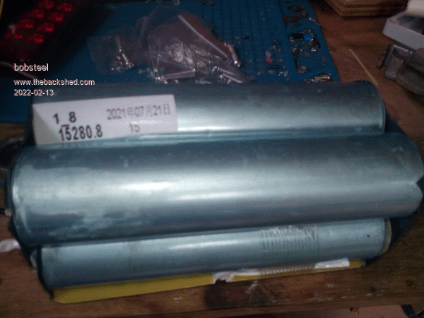

Generally fellas there is a lot of misinformation and bias in this thread . I'm not going to keep going through this rubbish arguing the toss .
What I suggest you do is get hold of say a 50 Ah 12 volt  LFP battery from ebay. Digi Marker I know and trust. about $190 AUD I think  You can afford to try that.
It has cylindrical cells of their own make in it ,I've looked .
So its discharge rate is constant 30 amps so its a bit limited . I use one to power my rideon . The BMS didn't like the larger current out (Its less as the volts don't sag) so I opened it up with a butter knife and shorted across the BMS so it could output the power I needed . Its lifetime will be less but what the heck I like to experiment .
Now when it comes to charging, the internal mower charger works fine and if needed I can put a modern battery charger on it . Check the battery charger is putting out 14 volts . 14.6 is maximum charging voltage.
I use one in my 5K generator too to start it and you can run your shed radio or security lights on it too. Wherever you have used that sh*tty little lead acid you can use it directly to replace it . Even in a small gas car. I run a 4 cylinder Pajero with a 135 Ah LFP without any modifications whatever .A 200Ah model handles my 6.354 6 cylinder diesel starting. A 100 Ah starts my 4 cylinder Fiat tractor.
So give them a try

Edit got me again . Here is the Pro Power I first opened up. I had the zero voltage cel out for the dendrite treatment.
Can't work out what the admin is doing with these pictures . Ive never seen so many ridiculous restrictions Admin . Its time you took another look at this . Everyone wants to edit there posts so they are coherent  and errors are removed . You don't allow it?
This silly little picture that comes up here ,you cant see a thing . Pointless posting it!
