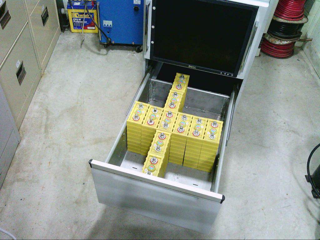

When one cell failed, I just bridged it out, so there was then 3.3 volts less. Then a second cell failed, 6.6 volts less.
With three now gone, the total battery voltage was getting down to the point that the Warpverter was not happy first thing in the mornings under load before sun up, so I just disconnected the whole battery at that point.

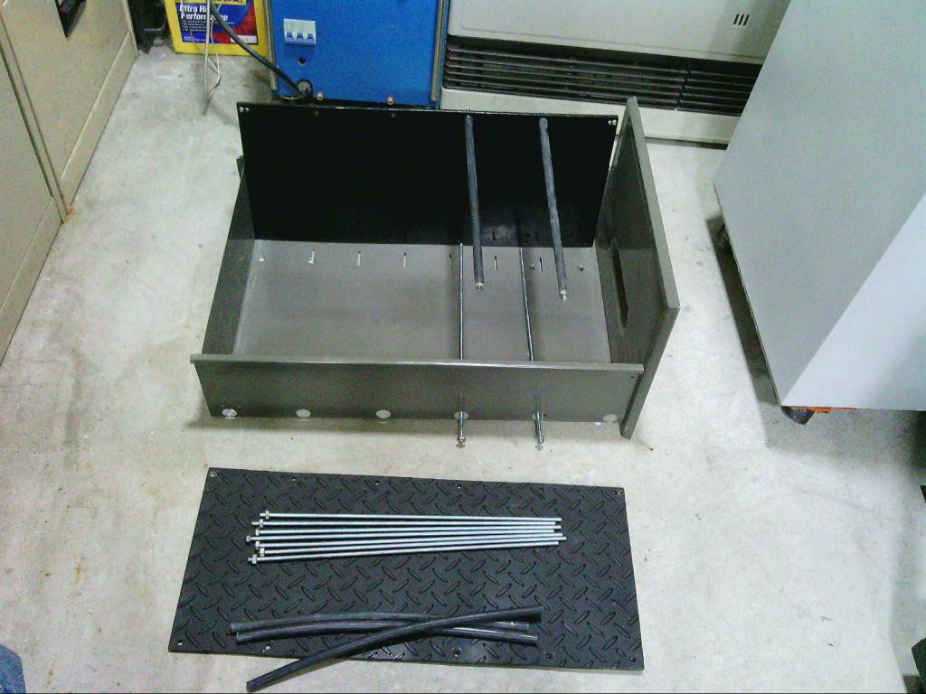

The thirty cells are stacked 6 x 5 between two sheets of 6mm steel plate. The steel plates are held together by twelve lengths of 6mm all thread.
The nuts are just nipped up, finger tight plus one turn.
That all fits perfectly into a standard filing cabinet drawer, with just a few extra mm of space all around. It makes for a very neat installation, highly recommended.
It would also work very well for a 48v system where cells could be paired, giving 15 cell pairs and 50v nominal.
The whole battery cannot really swell, but one cell can, but only very slightly.
And that is what you can see, its only a few mm bulge, but its definitely there on all three cells.
That is a Bloody Clever and neat setup indeed. Brilliant.

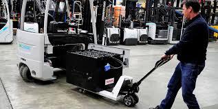

All the the fork lift batteries I have seen are usually constructed as a giant metal box  that can be removed as a complete plug in module with a fork lift, and the larger ones are incredibly heavy. One giant very heavy immovable cube!
On the other hand, large commercial stationary batteries commonly have all the cells lined up in rows on shelving, and cells can be maintained or removed individually. So shifting or installing a whole large battery could be done one cell at a time.
I am sure the battery supplier would supply just bare cells without the heavy metal box, which would just be an expensive and useless addition.

I suppose it depends on the size of the fork lift and the battery.
From what I am told, the basic idea is that a fork lift should be able to be totally thrashed by a minimum wage idiot, for a full eight hour working shift, and be able to fully  recover with an overnight eighteen hour recharge.
If it begins to slow down near knock off time, the minimum wage idiot complains to his supervisor, and management fits a brand new battery.
So a lot of pretty good batteries do get trashed, and might be gold for us solar crazies.
A different scenario is the people that sell second hand fork lifts from companies that go bankrupt.... Nice forklift, very few hours, brand new battery only $xx,xxx.
So the original battery might be down a bit, but again if the forklift sales shark can get more than scrap value, he is very likely to sell it to some gullible solar worthy.
Don't really know a lot about the fork lift industry, but I used to fix a lot of the fork lift electronics, and have designed battery chargers for the industry, and have heard the stories....

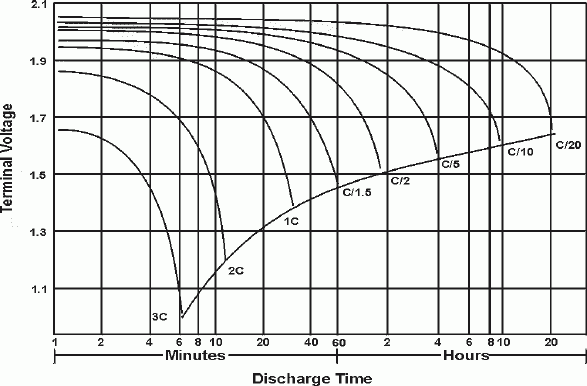

A C5 discharge rate means a 100 amp hour battery discharged at 500 amps over 12 minutes (1/5 of an hour).
No lead acid battery can possibly do that.  If it were possible we would be using lead acid batteries in all our drones !
Standard way of rating general purpose lead acid batteries is over a ten hour discharge rate or C0.1 so a 100 amp hour battery could deliver 10 amps for 10 hours.
Sometimes batteries for special purposes have other ratings such as C0.05 or C0.2 for example.
The ten hour rate would be about right for a fork lift battery that operates over an eight hour shift, and it makes no sense to use anything other than the C0.1 rating.
It would be about right for over night solar storage applications as well.
Reference battery university, which is the holy grail.
https://batteryuniversity.com/index.php/learn/article/how_to_measure_capacity
  Quote  SAE (Society of Automotive Engineers) specifies the capacity of a starter battery by Reserve Capacity (RC). RC reflects the runtime in minutes at a steady discharge of 25A. DIN (Deutsches Institut für Normung) and IEC (International Electrochemical Commission) mark the battery in Ah at a typical discharge of 0.2C-rate (5h rate) for starter batteries. A 60Ah battery would discharge at 12A.
If some battery salesman ever mentioned 20C with relation to a lead acid battery, I would run for my life.
That would suggest a three minute discharge time from a fully charged battery, down to the fully discharged end point, wow , like WOW.
