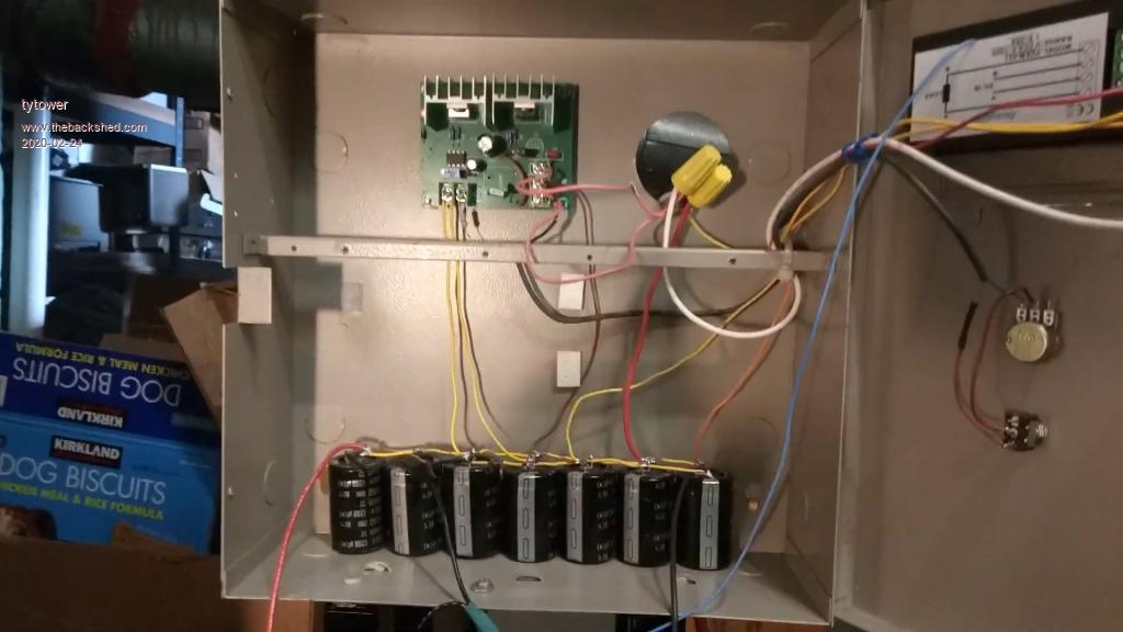

I have been working on something similar for many months and finally cracked it.
Rather than using inverter boards, I have used a a Battery charger board and a voltage level switch.
They are both 12V but I will use them to regulate an array of panels that will go to about 260V and run on a normal 240V element.
I'm using a voltage Divider to get the voltage from the panels down to something the board can handle and measure. The panels will charge a bank of caps to their open circuit voltage and then once they reach that, the board reads the voltage and triggers an SSR.
The Caps Discharge into the element and the board resets and repeats the process.
The boards have mechanical relays which are bypassed and the output taken straight to the SSR which require less power than the mechanical relays. The voltage switch boards have an upper and lower limit. I don't think the lower limit will be needed as it will climb fast just on the caps and I don't know if the board could cut fast enough anyway.
As warp worked out, 10% off power point does not make a lot of difference to the panels and as the load from the caps is minimal during charging, they seem to come up very fast and the cycling is also.
In testing with a 100W Bulb as a load and just one cap and panel late in the afternoon, I could not get any illumination from the bulb at all, not even the faintest glow. Even with the mechanical relay doing the switching (which is very slow in comparison to a solid state device which could also just be a mosfet or series thereof,) The bulb lit quite well. A very graphic illustration of the benefits of having the panels in their happy place.
Before this I experimented with just a PWM controller. This was also enlightening ( pardon the pun) as even with this, it was evident much more power could be gained over the course of a day throttling the load at a fixed rate than just having the panels directly connected which was hopeless.
The vids opera made no sense to me but reading here I got the idea of what needed to be done and worked out what I could use to achieve it.  I imagine the efficiency is still Horrible compared to what the smart people here have built but I'm happy I was able to work this out and it's a LOT better than nothing at all that's for sure.
From here I just need to work out what are the most common and easy to get boards as well as the cheapest that will do the job so I can do some step by step how to Videos and standardise the procedure for others to follow.
One thing I may need to do is work out how to measure the highly pulsed output to compare it to direct coupled.

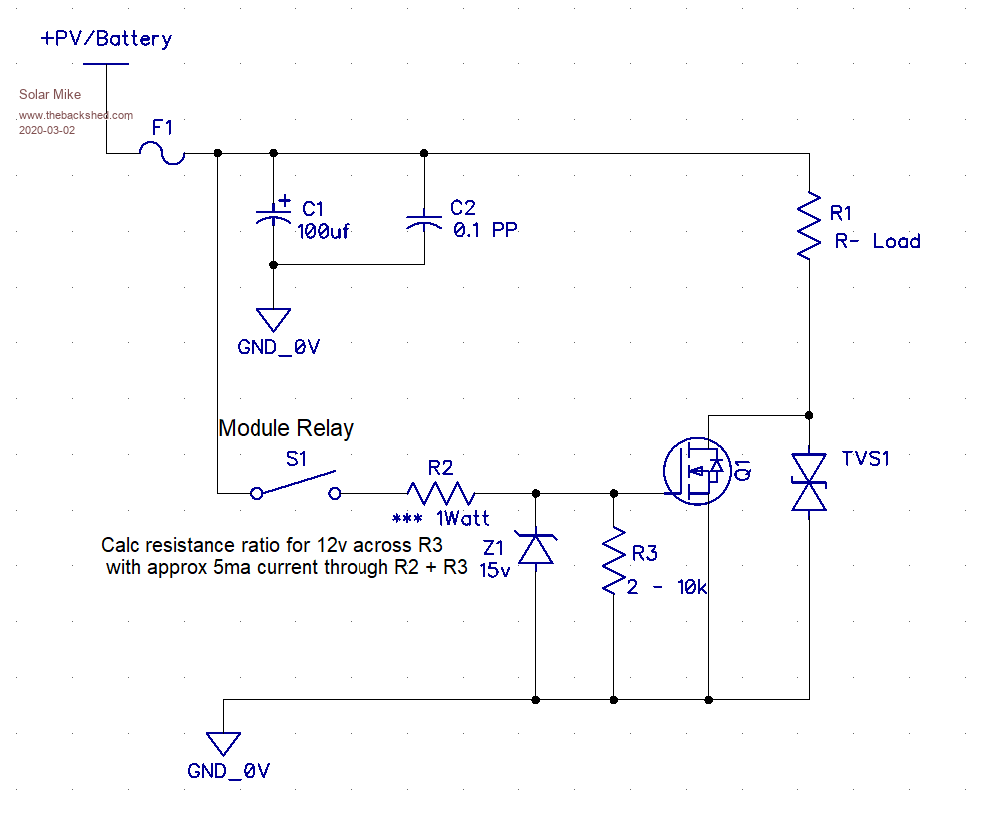

There are probably two fairly obvious contenders for mosfets.
FDA50N50 which is 500v 48 amps and rdson 95 milliohms these are available from e-bay for about $15.  I have used a lot of these, and are what I currently run in my Warpverter for the two smaller inverters.
TK62J60W this is a much more recent device 600v 62 amps and rdson 33 milliohms available from e-bay for around $25.
Either would do. I think I would prefer the cheaper device to experiment with initially, and probably the larger one for the final project once any bugs have been sorted out.
Its important to connect a transient voltage suppressor right across the mosfet source to drain. A 1.5KE350 (350v) or 1.5KE400 (400v)would be ideal.
How much heatsink ?
A 3.6Kw element might be carrying roughly 15 amps, and 95 milliohms would be 21 watts for one of the smaller mosfet. The absolute minimum for that might be about a five inch by five inch vertical flat 3mm aluminium plate, and something larger would be advisable.
A pair of the smaller mosfets would halve that power and spread the heat better.  Instead of 21 watts for a single mosfet, 10.5 total watts would be spread across two mosfets.  In other words about five watts per mosfet. That would be far better.
The larger devices are much better with 33 milliohms. One mosfet 7.4 watts and a pair only 1.85 watts each. That does start to get expensive though.
Its not so much the current carrying capacity as keeping the mosfets cool that will be the main consideration.

Solar Mike
Joined: 08/02/2015
Posts: 1255
Posted: 05:08am 02 Mar 2020
Hi Davo, that's a good find, keep us informed how well it works.
You could add a mosfet to the mix, see cct below; use the on board relay to switch a +ve gate voltage to an external mosfet or 2 in parallel.
If you need assistance in calculating suitable R2/3 values PM me.
Mike
