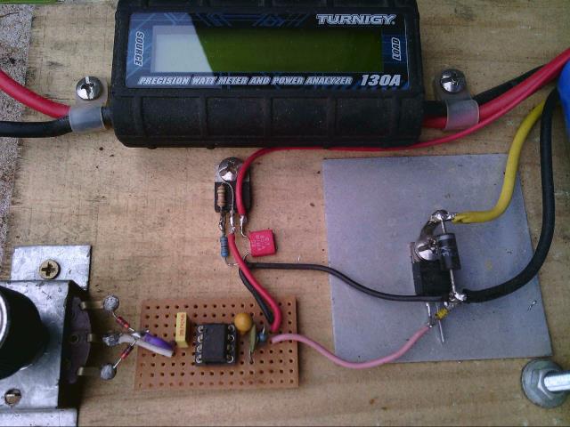

This schematic was stolen from the internet, but is how I did the duty cycle adjustment:
Its pretty rough and ready, but here is a closeup.

Is that a TVS across DS to help bypass any spikes that can damage the MOSFET?

  LadyN said   Is that a TVS across DS to help bypass any spikes that can damage the MOSFET?
Indeed, precaution, quite a lot of wiring inductance albeit damped by the element, however with 650v mosfets I dont think there would be a problem.

I even fitted a transient suppressor to the mosfet of my solar panel test rig, and its only for one panel, about 40v max.

You could put an inverse diode direct across the heating element. That is very often done when switching the coil of a relay for example.
But there will also be an inductive kick introduced by any long wiring, so the protection really needs to be right across the mosfet to be effective.
I used a 68v transorb connected directly across a 100v mosfet. You can see it clearly in the above picture.
