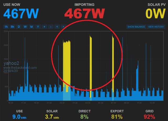

so what else can we tell from the boring ol data.
Well quite a lot as it happens.
As you will recall the yellow is measuring the water heater and no hot water was used this day. we can see a 2.4 kwh charge followed by two 700 watt boosts EXACTLY 210 minutes after the first one finishes.
some simple arithmetic tells me this heater is losing 9 degrees C over a 24 hour period and it is losing 200 watts per hour from midnight til morning and less than 100 watts per hour during the day.
so how are we going to improve it.
first item is distribution, there is a 24 meter uninsulated copper pipe going to the bathroom, the temperature of the water drops massively.
The second is to insulate the inlet pipe there is about 1.5 meters of pipe that is exposed and it feels like it is 60+ degrees. The tank has already had the original insulation replaced with rockwool and it sits on an insulated plinth that saved around 2.3 kwh when we did that upgrade. We have got some polyurethane insulating sheets we may even box the heater in with that as the rockwool is a little tight for perfect insulation value.
We done some decanting of hot water at the kitchen and at the bathroom and measured a few temperatures
At the kitchen tap it takes 0.67kwh to deliver 25 litres of hot water and at the shower it takes 2kwh to deliver the same amount at the same temperature.
If we can get the bathroom water temperature high enough then it might be possible to wind the thermostat back, that would save a lot of energy because the temperature differential inside and outside the tank would be lower.Edited by yahoo2 2018-05-01
Ummm.....
Midnight to 6 ? Am = 1200W, 6-6 = 1200W so your heater would be loosing 2.4Kw of heat just sitting there?
Substantial!
When I put the water heater on the Voltage monitor so it heats through the day the rest of the family said the water got hotter. I dismissed this at first although realised they were right. Your figures would seem to bear it out. We all tend to shower at night so the water may have been heating n hour or 2 before we used it.
With the off peak, it would have stopped heating closer to 18 hours before. that could have made a significant enough difference to notice as we did.
Does not change the losses or the energy input, just the water is used soon after it has been heated reducing the cooling in the tank.
As thermal losses are larger with more temp differential, it may turn out to be fractional more efficient this way. The water in the tank after we shower is cooler so the differential and the amount of heat loss may be less with the cooler water.

  yahoo2 said   I am a big fan of logging power use for a week or a month before making any changes to a system, just to see what is what.
So just looking at one 24 hour period we can tell a lot.
the yellow bars are not actually solar, I have hijacked that sensor to measure the electric HWS seperately.
the first thing we can tell is there are very few load periods that are over 2500 watts. interesting!!
second is the freezer runs for well more than 50% of the time and chews a lot of power. The fridge is the little wedge shaped pimple on top, they seem to run together a lot.
that needs to be fixed.
Third the water heater is poorly insulated and is leaking a lot of heat (those two reheat spikes should not be there, no hot water was used after midnight). so there are two solutions, adjust the timer to come on later and only do one heat of the water tank at night. Or redo the insulation I think it is just pipework that is the problem.
Four, if we ignore the HWS load there is under 5 kwh used from sunset till sunrise so if we add a margin or find out if the weekend loads are vastly different there is the potential to power this house overnight from 7-10 kwh of storage.
Five, the spikes we can see are boiling the kettle 6 times and running an induction cooktop a few times.
so what is the minimum generating capacity that would almost cover the load (assuming we move the HWS to daytime heating and only use solar if we can).
it is going to be daytime direct usage + hot water service usage + battery storage recharge.
in this case 3.5 kwh + 4.5 kwh + 7 kwh = 15 kwh /day
This is our starting point to factor in all the other stuff (weather conditions, power prices, etc etc)
so on the bleeding edge, 15 kwh/ day of generation, 8kwh of storage, a gadget to route solar to the HWS and an inverter that can do 2500 watts for 30 minutes reliably. plus maybe an auto transfer switch to go on grid if the batteries are low.
for places that get a lot of reliable sunshine that is a pretty small outlay for almost 24/7 independence. there would be a few days a year it might need some help from the grid or a small generator and charger.
with a few minor tweaks I think I could get the power usage down from 13 kwh/day to under 9 kwh.
a modern computer, tv and stereo will save 1.2 kwh/day.
the hot water service is wasting around 60% of its stored energy, I am confident i can shave 1-2 kwh/day from that.
fixing the freezer will save 1.5 kwh/day
That is about $600 saving from a local power bill at the current rates. for direct solar use it is only a consideration for the winter months, we usually have truckloads of spare energy for the rest of the year. Although there is 2 kwh off our overnight storage so we could fit a 6kwh battery or our 8kwh bank would last a lot longer.
the only loads we haven't looked at are,
dishwasher heater element
washing machine,
vacuum cleaner
Once again there are options to upgrade to lower instantaneous load versions if the existing gear is not suitable. Quite a few inverter washing machines play nice with off-grid inverters now.
I see mr Dyson is plaguing me with ads for cordless vacuums at the moment. Just saying! they might be crap I havent tried one, but it could be an option, I certainly dont vacuum for more than 20 minutes @ a time.
