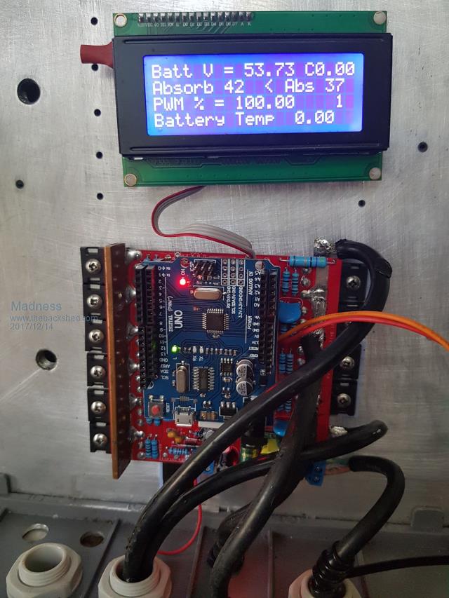

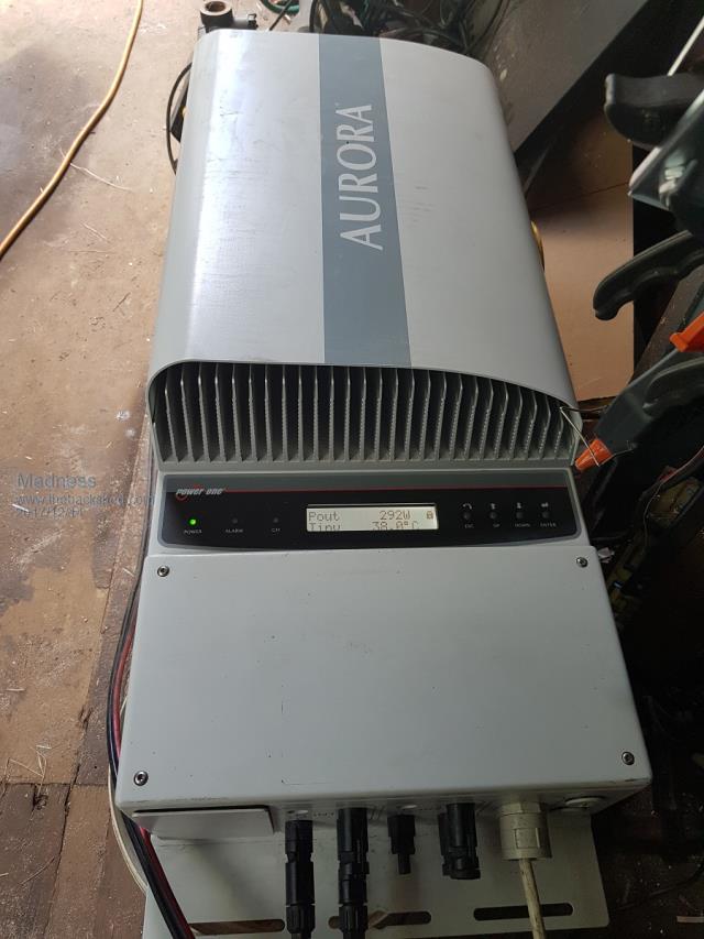

I am ironing the bugs out of a very simple and cheap charge controller ATM. This will control the power output of your GTI, it also allows the GTI to work at full boar when full MPPT optimised output is needed. In addition to this it will also control at least a 5KW PV array charging DC directly to your battery bank. With a slave board connected to it you could control another 10KW of panels. Cost will be around $100 to build both master and slave boards. You could substitute one of the low voltage DC coupled arrays for a second GTI.
This charge controller does not have MPPT for the panels not connected via a GTI. It relies on using panels that have a maximum power voltage just over 30 volts, by connecting these in strings of 2 the panels can charge a 48V battery bank at a normal Absorb voltage of 59V for flooded lead acid batteries such as a forklift battery. It may not give quite as much power as a MPPT charge controller but the money saved on a expensive charge controller allows you to buy a lot more panels and get more power for the same cost. The panels connected via a GTI will take advantage it's MPPT and give you the maximum possible. However you would only be able to connect one 5KW GTI to a Inverter that you intend to build, a 6 KW Inverter is not going to be able to take 10KW from 2 big GTI's.
The charge controller will also be programmable to control 2 solid state relays. I use this to turn on AC power to my hot water system when there is excess power available. You could use the second relay as I plan to control your AC to prevent discharging your batteries. There are many other possibilities to use power that would otherwise not be used. It is all controlled by an $5 Arduino microcontroller which we can program as we wish to do what we want.
Here is a couple photo's I took yesterday of the charge controller working with a 5 KW Aurora GTI, there was only one 1.5KW array connect at the time. The copper bar on the left side is for connecting the DC to DC panels, the right side is controlling the power to the GTI from the panels.
