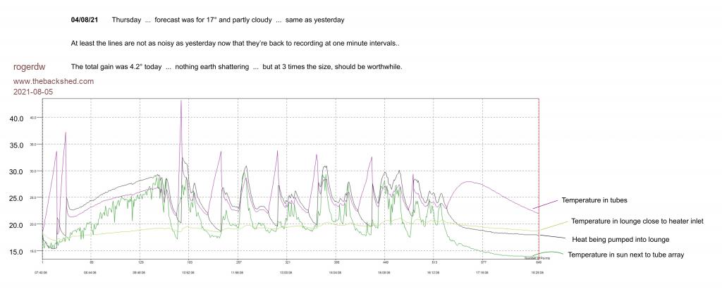

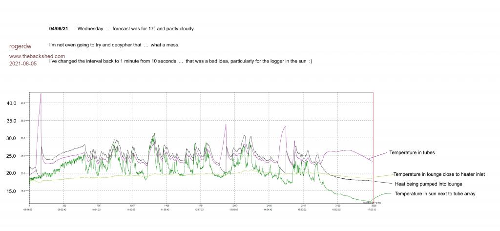

Looks like it was a bad idea to change the recording interval from 1 minute to 10 seconds  ...  so I've changed it back for tomorrow.
The logger in the sun chops and changes so much that there's an awful lot of noise and it's hard to make any sense of the rest.
Otherwise it wasn't a bad day.

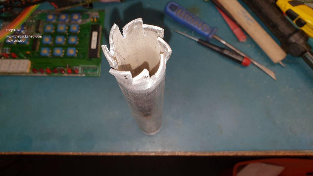

This was the idea I suggested the other day to get the air to swirl around as it exits the tube. Probably not worthwhile but at least not too hard to do.

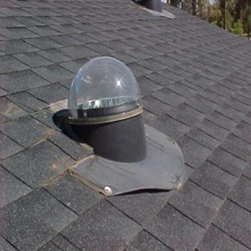

  Quote  The only thing I haven't worked out yet are what I'll use to feed the duct through the roof.
I think you should be able to buy a kit to feed a flue from a wood heater through a tiled roof. The outer most skin of that may be large enough.
Another random thought, I have seen small round skylights advertised that pipe sunlight down through a reflective tube. Some of the hardware for that might work.

  rogerdw said   The only thing I haven't worked out yet are what I'll use to feed the duct through the roof.
Dektite

As far as getting past the roof tiles goes, you might be able to do something really clever with some sheet lead, and a really big soldering iron...

I followed the Deks link and eventually discovered that Bunnings sell a couple of them. I'd been using the wrong description. Their 150-300mm one is $41.60.
While I was out I called in and looked at them  ...  and they'd certainly do the job  ...  though the base is not very much wider than the rubber  ...  they're more suited to a tin roof where you could glue and screw them in place.
Reece have one for tiled roofs but is $200 in the 300mm size  ...  and that one does have a quite large sheet of lead or a substitute  ...  to give a wide protection area.
Bunnings also have sheet lead up to 600x600mm $56  ...  so if I fitted their rubber sleeve to the lead it'd cost ~$100
Another thought I had was to get out a handful of spare tiles and see if it was possible to panelbeat a sheet of galvanised tin to a useful shape  ...  then fit one of the Deks ones from Bunnings onto it. I'll need two anyway, for the inlet and outlet.
And the thought just came that if I could shape some tin well enough, I could fit a ready made galvanised duct joiner through it and solder it all up. They're only $10 or 15. Then carry on with flexible duct inside and an elbow above.
I'm not sure what to think about lead though as we drink the rainwater off the roof  ...  and of course some say that is deadly  ...  and others say don't be stupid, it's perfectly ok. Not so concerned about myself with only a few years to go  ...  but the kids are a different matter.

More results from today.
Certainly better with one minute recording intervals rather than 10 second.
Cheers,  Roger
