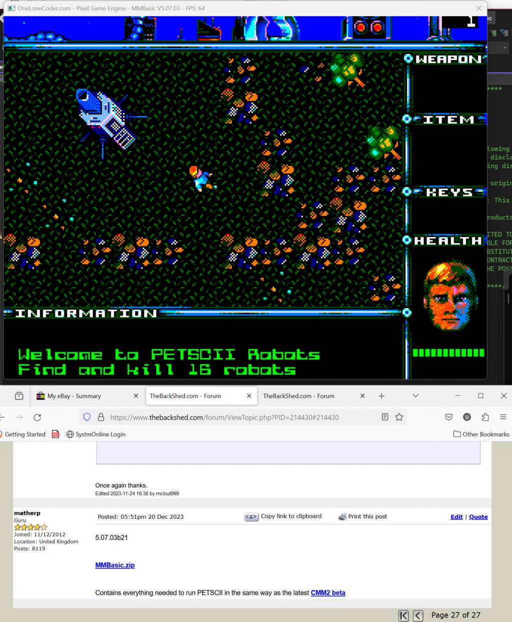

Posts: 12040
Posted: 05:51pm 20 Dec 2023
5.07.03b21
MMBasic.zip
Contains everything needed to run PETSCII in the same way as the latest CMM2 beta
Edited 2023-12-21 03:53 by matherp

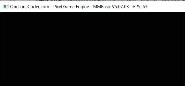

Posts: 3885
Posted: 10:33pm 20 Dec 2023
For many months now across at least three versions of MMB4W, I get just a blank screen, like this:
I don't have a ">" prompt, and no matter how many times I hit <Enter>, I never get one. CLS RGB(RED) has no result. The window closes if I type "quit" and <Enter>.
I've deleted the .options file in MyDocuments without any change in behavior (it's recreated when I run MMBasic).
I'm running Win10. MMB4W worked for me for a long time after it was introduced. I have no idea what changed to cause this current behavior, and no exact memory of when it started.
Any ideas about how I may fix this?
EDIT: I've just found that if I type MODE 2, I get a prompt, and CLS RGB(red) and CLS work.
EDIT2: And now, everything runs. What weird state was I in that was fixed by entering MODE 2?
Edited 2023-12-21 08:44 by lizby
Posts: 12040
Posted: 10:44pm 20 Dec 2023
Press Auto on the monitor
Posts: 3885
Posted: 10:51pm 20 Dec 2023
  matherp said  Press Auto on the monitor
This is a laptop.

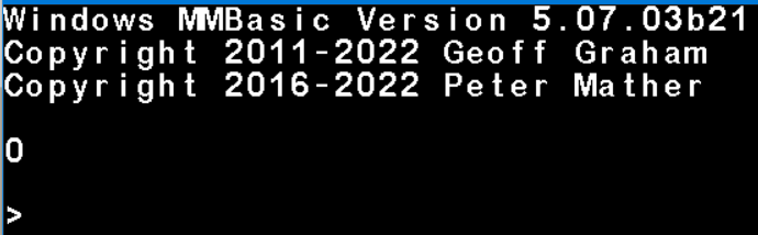

I have been testing the INPUT command and the INPUT$ function after results from another post. I have an MM2 which is connected to COM3 and it is running the program:
DO
PRINT "Hello I'm the MM2"
PAUSE(10)
LOOP
I have verified the output using Teraterm
Using MMB4W running this program:
OPEN "com3: 38400" AS #2
test$ = INPUT$(20,#2)
PRINT test$
CLOSE #2
I get this result:
If I run this program:
input #2, test$
print test$
CLOSE #2
MMB4W opens and crashes and I see nothing
Both programs work as expected (by me) in MMBasic for DOS. Sometimes the result is garbled until it is synchronised by the PAUSE in the MM2 but that is not surprising.
I believe this is a bug or 2 unless I am doing something stupid.
Edit: Forgot to mention that TassyJim found this but it seemed to go unnoticed.
Edited 2023-12-21 15:25 by Turbo46
Posts: 6626
Posted: 06:03am 21 Dec 2023
Sending data out the com ports is working.
Just not receiving.
Tested with picomites and cmm2 (CH340)
Posts: 12040
Posted: 08:07am 21 Dec 2023
Try this. Definitely works for me talking to the console of a CMM2
MMBasic.zip
Turbo46
Joined: 24/12/2017
Posts: 1694
Posted: 09:12am 21 Dec 2023
Works the same as the previous one for me. Did you send the new version? It's the same size as before.
