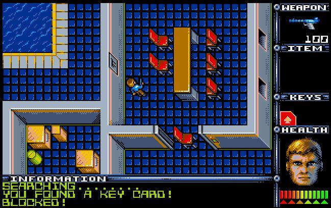

  Volhout said  Here is a version with a working trash compactor, and some other bug fixes.
Also the rollerbot walks (rolls) faster (as true to the original) and fires faster.
Known bugs: when attacked by 2 or more robots at the same time, you can walk away from your death.... OOOPS ...
pet24a.zip
hmm
How do I get the TC to work?
If I pull a chair, a crate or myself into it, it does nothing.
I noticed that things , that you are moving disapear when they stand in the doorway and the Door closes..
in Dos Version the Door is blocked

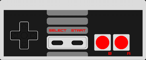

I added NES Style Controller on port A (the Left port) of Mixtel90s PicoGAME VGA Board
pet24an.zip
Controlls are translated like on Game*Mite
But         Returns Key  Action
"DOWN "         Chr$(129) 'down
"UP "           Chr$(128) 'up
"LEFT "         Chr$(130) 'left
"RIGHT "        Chr$(131) 'right
"BUT-A "        "m"       'Move
"BUT-B "        "z"       'Search
"START "        " "       'Start
"BUT-A & BUT-B" Chr$(9)   'Tab
"BUT-A & DOWN   "s"       'Fire Down
"BUT-A & UP "   "w"       'Fire Up
"BUT-A & LEFT"  "a"       'Fire Left
"BUT-A & RIGHT" "d"       'Fire Right
"BUT-B & UP"    Chr$(145) 'F1
"BUT-B & DOWN"  Chr$(146) 'F2
"SELECT"        Chr$(27)  'ESC
FOR GAME*MITE SET
Const nesPG1=0 'Nes Controller on Port1 Pico Game Board
at the Start of the Program
Have Fun
Edited 2023-11-14 02:54 by Martin H.

- chair in door: fixed
- game_end music: fixed
- trash compactor: only sprites (overlay) implemented now, and atm player is excluded. (easy change, but I though this was a nice twist.. you can outrun a chasing hoverbot into the TC, run to the end, you will not be harmed, but the bot is crushed..
I will investigate changes. Problem: chair=tile showing chair with floor element (blue). hard to use as sprite to overlay. May need chair with magenta background. Same for each other moveable item (chair (4 rotations), canister, box open, box closed, small box open, small box closed, hocker) or we need to accept that floor element is also copied into the trash compactor.

On pet24b the NES controller on my PicoGameVGA does not work.
In the startup menu I can press UP/DOWN and START, but in the game it does not work.
pet24b.zip

  Volhout said  On pet24b the NES controller on my PicoGameVGA does not work.
You just missed one of my changes
change
   'player input through keyboard, clearing buffer, check loop time
   k$="":Text 290,0,Right$("00"+Str$(Timer,3,0),3)
     tmp$=Inkey$
     If tmp$<>"" Then k$=tmp$  'keep last valid key
   Loop Until Timer>h_beat
   Timer =0
   If Game_Mite And k$="" Then k$=c2k$()
to
     tmp$=Inkey$
   Timer =0
   If k$="" Then k$=c2k$()
Function "c2k$()" (the translation of Controller Input to Keypress) should now allways be called, if there is no Keypress.
