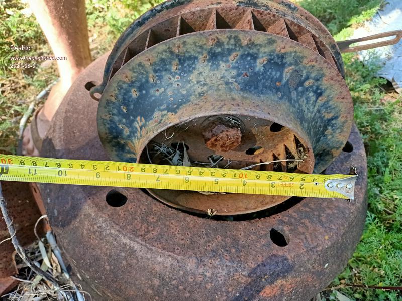

Posted: 02:47am 01 Aug 2021
VW Fan, just checked the one down the back, yes 150mm ID, 230mm OD and about 75mm deep.
Cheers Aaron
Off The Grid
Posted: 02:52am 01 Aug 2021
Perfect !!
Thanks Aaron.

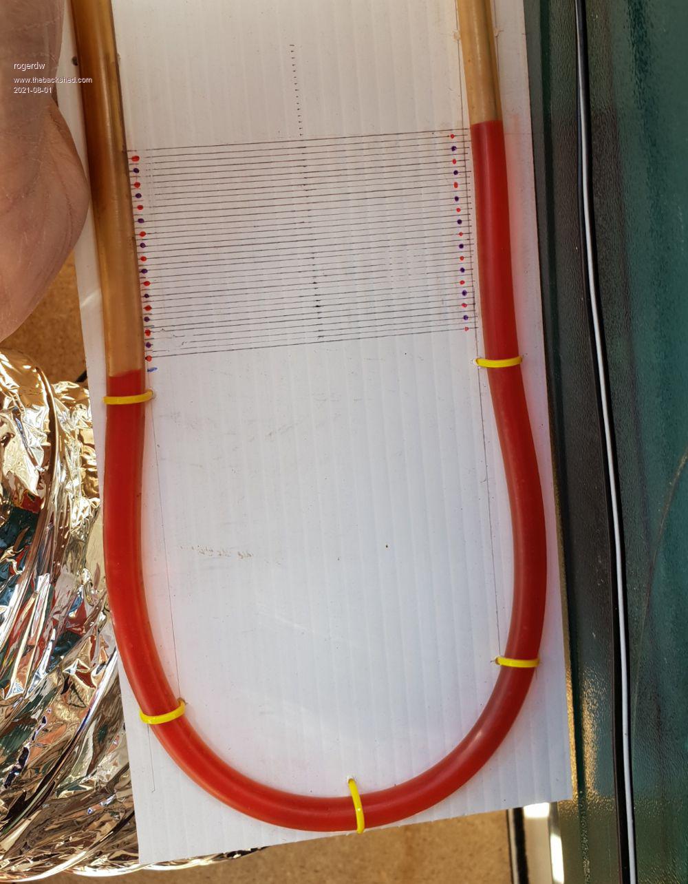

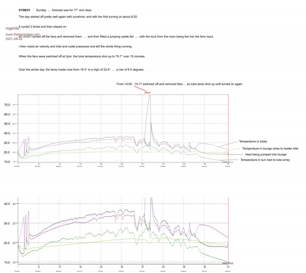

I do have some further news  ...  it's been a brilliant day for the machine today  ...  but at 2pm I switched it off, ripped out the inline fans and plugged a jumping castle fan directly into the end of the cold manifold.
Took just over 15 mins and was back on the air.
Anyway, I was able to take some readings, so hopefully they can give you guys more insight.

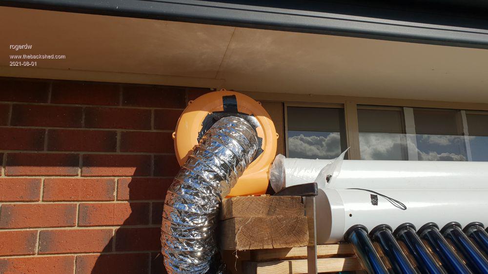

Removed all other fans and added jumping castle fan directly into cold duct  ...  plus fitted the duct from the room into the inlet of the fan
(Specs.  430-450 W  ...  ?? cubic mtr/hr)
Inlet Manifold = 2.1875"
Outlet Manifold = .6875"
Outlet Air Velocity = 28.34 ft/s
Power = 363 watts (when I blocked inlet, dropped to 205 watts)
I had to laugh when I took the inlet pressure  ...  just off the scale!!!
Cheers,  Roger
Posted: 06:40am 01 Aug 2021
Wow !
28.34 Ft/sec x 0.1726 = 4.89 cubic feet per second = 293 CFM.
A really big jump possibly more than needed, but we shall see what the tube temperatures look like in a nice clear blue sky.
How about the noise level of this big orange monster ?

Posted: 02:15pm 01 Aug 2021
  Warpspeed said  Wow !
Thanks, was pleased to see the result  ...  and Dave was right all along, it was definitely worth a try.
The fan is noisy, but being outside helps a lot  ...  it is the air rushing into the inlet duct in the lounge that makes the most noise from inside. But overall, much quieter than having the 8" fan running inside.
I also reduced Ld from 8 degrees down to 5, which is what Tony suggested right at the start.
As I've watched the system switch on and off, I've decided it is ok to have air pump in in the low 20's when the room temperature is only 16 or 17. We'll see how it goes.
I want to address your other comments above, but I keep nodding off  ...  been a long day, sorry.
Cheers,  Roger
Posted: 10:09pm 01 Aug 2021
Very nice Roger, the tubes are now running at less than ten degrees hotter than the house and you have pretty much reached the point of diminishing returns of heat recovery.
With more tubes and less flow restriction, that blower should do very well, even with extra added ducting length.
A six degree rise is excellent, and pretty amazing.
As the days get longer, things can only further improve.

Today's a bit of a write off. Sun started nicely this morning but just before lunch the cloud came over and the rain set in. It's freezing now  ...  well by SA standards anyway.
