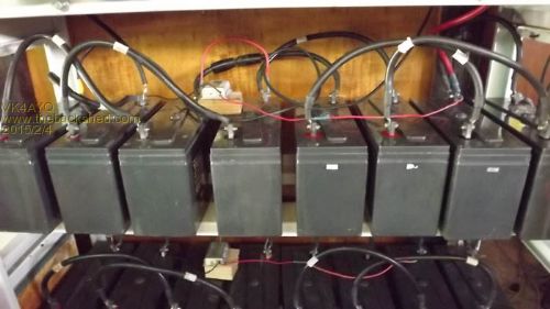

Note the desulphator across the 24 volts at the moment these are commercial units Infinity brand that have worked well for me and are rated for 1000 AH.

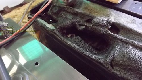

I have a battery that the top burnt out of in a fire in my shed several years ago and it sat under the bench flat for two years, after I cleaned all the ash and melted plastic off the top of it, I decided to have a go at reviving it.
The lead connectors in it where covered in white sulphate once I cleaned the burnt an melted plastic off and the top of the plates where a mass of sulphate, now several months later it has all cleaned up back to nice grey lead on the connector and no sulphate on the top of the plates, proof that they do work contrary to what a lot of the USA experts say. Note the sulphation on the connector on the left side of the picture.

I am going to use bank 3 as the workshop supply using the old inverters that are lossey when left on all the time, they are OK for short term use and as I do not do allot of work in the workshop in the heat at the moment. They run all the 240 volt things including the welder and plasma cutter so are very useful.

I do not think that you need to get a vacuum to aid the process as the slow part is really rehydrating the sulphate so it can be broken down into acid and lead again. A light tapping of the case sides brought some bubbles initially but it took time to soak into the matrix, which I presume was nearly dry as I added nearly 1 liter of water per cell over the two months, one cell with the top burnt off is still absorbing water, but it had sat under the bench for several years as well so was really sick.
Not all cells have responded and I have had to discard 8 batteries due to case leakage internally allowing the electrolyte to be on contact with two cells, I may cut the offending side of and recharge to see if the cells can be salvaged by resealing the side with a piece of lexan just for the exercise, I wouldn't trust them back in the bank but may be useful for something else or to prove a point.
All the best

I may have been a little gung-ho with my watering and done them a bit quickly after all - though I did stop as soon as the water didn't soak away immediately - so there's just enough on top to be visible - but as long as they soak it up eventually I'll be happy.
Actually I was thinking that if they were bubbled for a bit, that it would expel anything but oxygen an hydrogen from between the plates, then when they're let stand for a while, the recombination of the gasses would remove the bubbles from the plates and suck the water in - when I let them stand with the rubber vent caps on, the caps develop concave tops and when removed again there's a sucking noise indicated that the resting cells do seem to develop a vacuum.
I've also thought of another question (sorry):-
I gather from your posts Bob that your battery shed is generally quite warm? 30 or 40C + ? I seem to remember from school that ionic solids (like sail of sugar) dissolve better in warm water than cold which made me wonder if the sulfate would dissolve better in a warm electrolyte; i.e. if I want to desulfate my batteries, should I warm them up a bit (my shed is barely above freezing at the moment).
