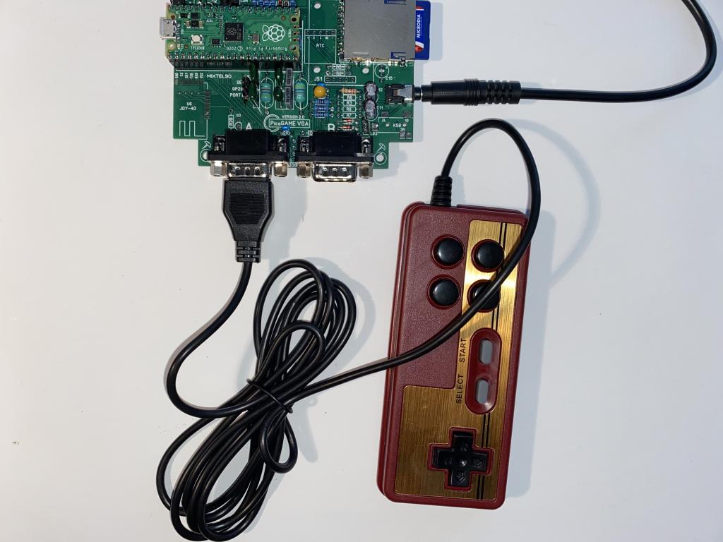

Hmmm. I'm not sure of which gamepad I have then. It's switched. See PHOTO below.
I bought it from Ebay Australia and it arrived in 3 days:
https://www.ebay.com.au/itm/355051578514
It works well with the PicoGAME board.
P.S. Many thanks to Mick Ames for the PicoGAME VGA design. I had fun making it.

Posts: 9233
Posted: 09:54am 12 Nov 2023
That's the original Famicom controller design. It pre-dates the Super Nintendo NES IIRC.
I'm pretty sure it's the same internally.
Glad you like the board. :)
EDIT:
No, it's not the original Famicom. That doesn't have 4 buttons on the right. It looks more like a Famicom clone of some sort. There's a few pics almost half way down this page.
Edited 2023-11-12 21:56 by Mixtel90
