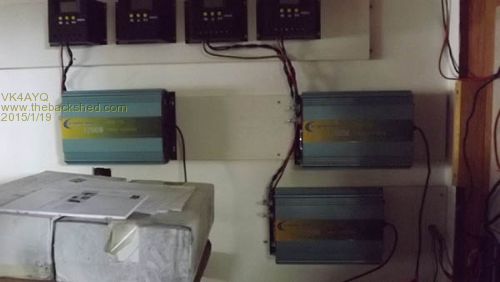

Hi Gww
I have the same trouble with the TV wife puts it on and then not watch it so it is going in the background most time. It will have a failure one day when she isn't home and will be replaces with a more economical one.
On your loading problem you could put a water radiator on the HWS and a small circulation pump, in winter it would help the heating bill.
A couple of the plug and play GFI units could return excess power from the panels to the grid and run your meter back a bit, when connected across the panels the GFI draws only a few milliamps until the regulator shuts power to the batteries then the panels increase in voltage because of no load and it fires up the GFI 55 Volt ones in your case, I use 28 volt ones on my system.
You could do the same with your turbines feed them through a solar regulator for the same effect. Better than wasting all that excess power and gives you a bit up your sleeve from the grid when needed.

Hi Gww
The feed in is a point of contention here to, I have an installed unit that is now in negative earning due to fees and charges levied on it, that's why I am going back to self powering and the mains is a backup only and will run the airconditioning when required.
I am not worried by not getting paid for feed in but will still get credit KW HRS which I can use in the workshop and heating and cooling, it is more important to me to buck the system and do my own thing with power.
No more contracts for me either, as they are generally only a trap for young players, my first contract has now expired but still get some feed in pay 44 cents KWH but that in reality doesn't cover the government tax, and power company charges. I will be reconfigure the solar panels now the contract period has expired as the way they are set up is very lossey and I loose nearly 30 % of rated power due to series connection of the panels. with the older type meters if the wheel run back it subtracts from power total so you do not get paid for the power but it is a credit that is what mine did until they came and fitted one of these new fangle things digital meter to my power board, but even it when driven it reduces the total reading but also tells the solar input on a separate digital scale
I have 4 KW of solar cells I was going to make my own panels with but it would have cost as much as new panels now prices have come down so they are still in the box in the shed, things may change in the future so will leave them sit for the moment.
The electric space heater is a good idea you could make a voltage dependent switch to switch it on when your voltage reaches float and save you remembering to do it also could be used to heat water if excess power is available.
My HWS is a solar unit 300 ltr capacity and for 9 months of the year it boils on sunny days, but cools of in the winter a bit if we get to much overcast weather, it is the best investment I made on the initial solar installation as it saved 10 KW a day.
It has a 4 KW boost element in it for winter use but I found that feeding 24 volts into the element keeps the water warm enough to be useful in winter I can't remember the current it draws but I think it is around 300 watts, it is hooked up to the solar regulator so it comes on after float voltage is achieved. The regulator is a Chinese thing that has programmable voltages for float and equalize, every day it goes through its program charge to equalize for 15 minutes, then drop back to float so I set the equalize at 28 volts and the float at 27.5 volts I tried to have the float and equalize the same but that gave the regulator a nervous break down and went into error mode so I had to compromise a bit.
I am thinking of fitting a few panels on the back of the roof to get a bit more spread of charging as you have done, they are sitting in the shed gathering dust at the moment.
When you run out of other projects you could fit a pressure chamber to the water supply to stop the pump cutting in and out so much, I have a 40 ltr one and it made a difference to the pumps power usage. I will put in a gravity feed system this winter but maybe to cold over there for that for you.
